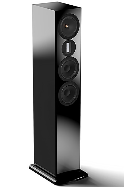

Today is a happy day! It seems that as of today we have a new record holder for passive speakers (without subwoofers)!
Congratulations to David Fabrikant from Ascend Acoustics!!! Incredibly nice in-room-response especially after a little bit of equalizing!
Buying a Neuman, a Genelec, a Dutch and Dutch, an Epos ES 14N or just the new Ascend Acoustics ELX Ribbon Tower - hard decision!

What I'd lkike to hear is if that tweeter integrates with the mid drivers properly. Maybe some of that would come up in a dispersion plot but listening is always important and an on-axis response plot won't always show this up.

I wonder if preference score over-weights for bass extension. The ELX has F6 right around 35hz which is quite respectable. But I have seen a smoother overall response in my day. Not a lot smoother, mind you. Perhaps the "with sub" scores are more revealing then, since bass extension is, after all, typically a solvable problem if you add subs.
The formula looks to be here:
LF extension (specifically -6db) is weighted fairly highly, just slightly below on-axis response. The ELX's F6 is very good and certainly helped the speaker to reach the elusive 7+ preference mark. Yeah, on-axis isn't textbook perfect and several active speakers / studio monitors can best it (Ascend's own LX bookshelf is flatter), but it's still very respectable and linear enough to be considered neutral. PIR also makes a big contribution to the preference score, and the ELX is nearly as good as it gets here.
From a purely subjective standpoint, I don't think I've ever heard a speaker I've liked more. I'm not sure what could be appreciably improved...perhaps a cardioid version to help reduce SBIR.
