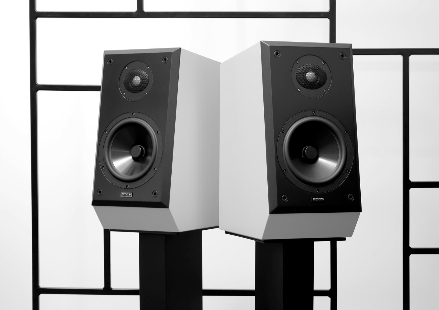

Fink resurrected the ES 14 from Epos in 2022 as the ES 14 N.
Then look at the unbiased database www.Spinorama.org
Damn: Its new Epos ES 14 N is the best passive speaker in the entire database (over 300 passive speakers - you have to choose: Measuring Quality high!).
Anyway, if you click that even a little equalizing is allowed.
Even without equalizing still top ten of the passive speakers.
Why is it so good?
1.
The radiation into the room is wonderfully even. So it can be corrected perfectly. So with Fink's boxes, the room also has a harmonic frequency response. Everything seems more natural. Some frequencies are not preferred at certain radiation angles - which ruins the localization with many loudspeakers.
Studio monitors are often only clean on axis. They need an extremely damped room to sound really good. Gregor and I heard this among other things in the room acoustics lecture.
Fink's Epos ES 14 beat even the Neumann KH 150 (also with some frequency response correction) In the living room, the Epos are winners!
2.
The cabinet walls are thick and the baffle is 4.5 cm (1.75 inches) thick.
Wilson sends its regards here as well!
3.
The speaker is slanted a few degrees so that the acoustic centers of the midrange are at least a few cm in front of those of the woofer and everything reaches the listener at the same time.
Also Wilson philosophy.
4.
The magnet systems of the drivers are made in such a way that distortion is minimized via shorting rings.
Also, crazy mix of materials for the magnets and most elaborate design of the drive.
Again, Wilson: Gregor, a friend of mine, did note that the drivers are off-the-shelf externally (Top Scan Speak series). In fact, Wilson emphasizes modifications and their own ideas in the drive.

The distortions of the Epos ES 14 N are, due to the massiveness of the speaker and the great magnet systems, the lowest I have ever seen in a measurement write-up in my life - and I have been reading stereoplay for 40 years! All distortions at 87 dB below 0.4% - and even in the bass down to 60 Hz. (Klippel System used!) Mostly even below 0.1 %. The Geithain ME 901 is perhaps similarly clean and comes down an octave in the bass - but otherwise I can't think of such a clean speaker. Even the best Neumann studio monitors, at least the record holders from Amir, have about twice as much distortion between 60 and 120 Hz!

EPOS ES14N
