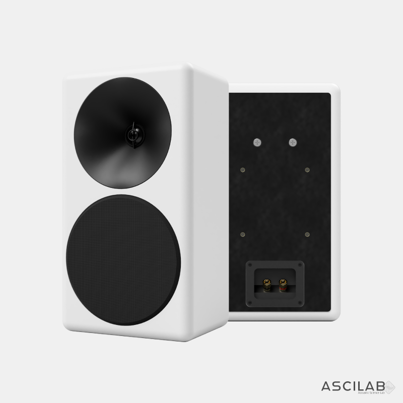

This is a review, detailed measurements, EQ and listening test of AsciLab F6Bs bookshelf/surround speaker. It was sent to me by the company and costs US $575 [now $725 with shipping included] for a pair.
This is an absolutely gorgeous design! It feels that way as well with a solid cabinet that is neither too light, nor too heavy. I didn't know if the grill over the woofer came off so left it alone. Back side shows that it is a sealed speaker:

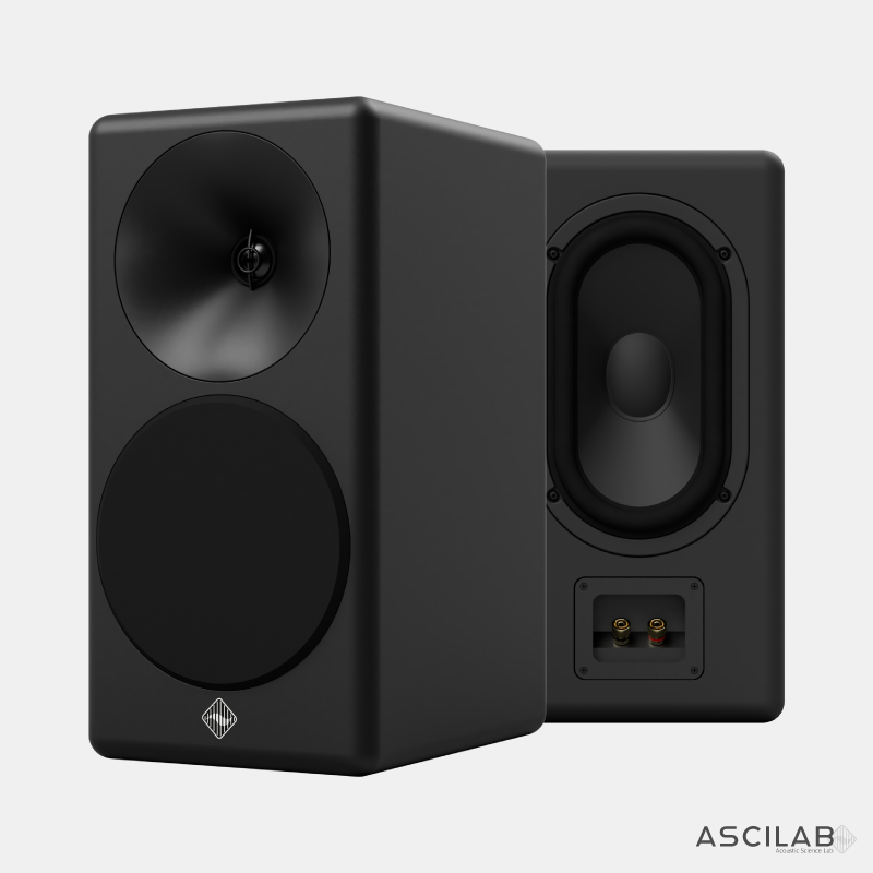

AsciLab F6Bs Passive two-way speaker surround bookshelf back panel review.jpg
Company uses Klippel Near-field scanner for testing which as you all know, is the same system I use. I reviewed my measurements with them and they concur with those results.
