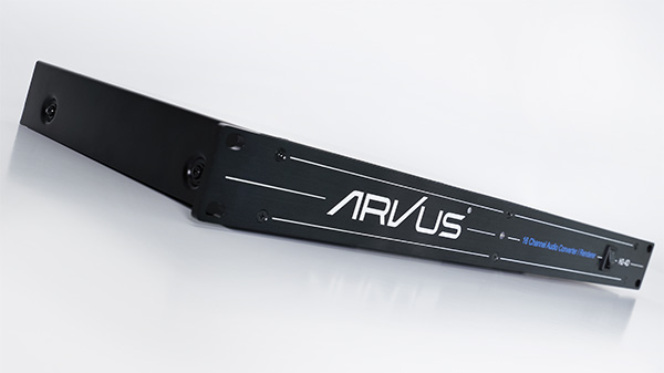

The tough part is that you cannot effectively get Dolby Vision/Dolby Atmos from a PC. The closest homebrew setup is to use a Mac and the AppleTV program lets you output to 8 channel DACs. This is still a bed layer experience only.
The Arvus H24D
is cheaper than Altitude and gives you Atmos with AES digital output. You may be able to combine it with a Trinnov Nova to process some of your channels.
Last, dollar for dollar, the Monolith HTP-1 is the best way to save money on a processor. Even with another ADC stage after the unit, it’ll still be very good in terms of sound with Dirac and DLBC.
