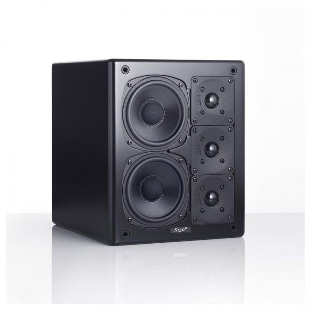

Preference score (as per Erin): 3.4 (/w sub 6.4)
Conclusion:
Listening was mostly within a couple meters, though I did back out to 4 meters at one point. Why close? Because, the majority of the reviews and talk I saw about these were with respect to their “monitor speaker” use. Some certainly use them in home theater applications. So, I varied my listening distance and even the angle of the speakers. Below is a very brief summary of what I heard and how it relates to the data.
  • Very bright speaker. Estimated in-room response backs this up with nearly a flat response other than in the crossover region.
  • Shelved midrange/midbass.
  • Gets plenty loud with low distortion and compression through the midrange and treble.
  • Pay attention to placement because the horizontal radiation pattern changes due to the tweeters having been placed to the side of the mids. Namely, note the suckout in response that is speaker side (left, right) dependent.
  • Poor directivity through the crossover region. I’d recommend some serious room treatment: side, front and ceiling absorption with this speaker.

Doesn't look like a speaker which gets a recommendation here.
Yikes that looks real bad, what's the point of driver arrangements like this supposed to be?? You ruin your horizontal dispersion for... what exactly?
Mostly aesthetics I think. I don't see many speakers that have multiple tweeters like this.
People buy whatever looks unique, without any understanding of it's design.
Guess higher vertical directivity, THX also recommends such vertical tweeter arrays, but it shows that doesn't work well with such few drivers and not using shading.
What a bizarre speaker. Why...
Output obviously. The tuning is also for flat sound power which would work better with the speakers shoved into a wall in a home cinema setup.

Tweeters on the side of the woofers tells anyone who understands crossovers that this speaker will have bad and uneven polar diagram without even measuring it.

Around 15% of Silver 5L customers had ordered replacement tweeters. The crossover is 1500Hz 4th order LR.
The speaker is supposed(?) to have foam(?) pieces around the tweeter, Isee that for RAAL tweeters and some Wilson Audio tweeters, I wonder how much of an effect it has.
The old versions of this did use foam pads, the more recent ones don't

And Abbey Road uses B&W. None of this changes the measurements. :rolleyes:
I asked is there something worrying which can be fixed with little eq and speakers placed optimally in treated room? I see lot of negative remarks for products if they don´t measure as good as Revels and then other people come calm down saying it really isn´t as bad as some make it look. I can´t understand all these measurements as good as you folks so i´m wondering are people over reacting here or not. :)
The speaker is flat on-axis, which means for people sitting right in front of it in a treated room it should be okay.
Not Revel! As good as Genelecs and Neumanns.
Why make weird when it's easy to do simple with good measurements and super good sound.
