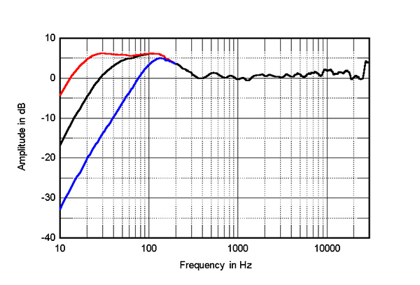

BTW, compare my measurements to that of stereophile:
They really need to correct for their near-field response error (the bump). It makes speakers like LS1c look bad for no reason.

Yes, I was just looking at this plot.
They explain the difference is the cut out frequency:
nearfield response of the woofer with the low-cut frequency set to 20Hz (red), 40Hz (black), and 100.2Hz (blue)
But if I understand it correctly, that's without the sub.
With the sub, that should be more like this:
As is, the low bass response in your plots is surprising for a speaker at this price.
That's why I'm asking.
