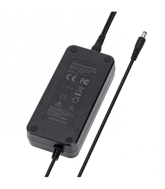

Would it be possible to have an external like this?
It is not an usual practice but works performance but at the risk of sacrificing performance

How about using an external?

Well as I wrote before. I have sold some expensive equipment so the budget for this project isn't a problem. The reason I ask about external power supply is because I have an extra 48V Fosi PSU and I have a small case that only fit the amp board.
I am in the planning stage right now. I will get back later when I got all information.
