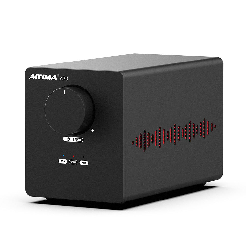

This is a review and detailed measurements of the AIYIMA A70 stereo class D amplifier. It was sent to me by the company and costs US $190 with 48v @ 5 amp supply. As tested with 48v 10amp GaN supply, it costs US $220.
As you see, the A70 comes in vertical desktop configuration. Controls are easy: push the button for power up and again to cycle between XLR and RCA inputs. Hold it for a few seconds and it goes into standby. Back panel shows nice inclusion of balanced XLR inputs:
AIYIMA A70 Class D Stereo Amplifier with PFFB balanced back panel GAN power Supply Review.jpg
Yes, that 10 amp brick is the mother of all external power supplies! :) At 480 watts, any heat dissipation would be challenging given the sealed box. Use of GaN transistors seems to have enabled high efficiency as it hardly warmed up during the testing. The amp's heat source is on the bottom. I wish the feet were taller to allow better convection cooling. Fortunately that area didn't get too hot in testing.
Nice to see trigger input to allow one button power up of the audio chain from the source. We also have a sub output wit variable filter output (yes, it is controlled by the volume setting).
Diagonal speaker terminals help some to fit beefier speaker wire termination.
There is a switch to add 3 dB of gain to RCA input. I didn't realize this until after testing. It is a smart move as the gain otherwise may be a bit low for some people.
The A70 is one of the few TI TPA3255 chip based amplification utilizing post filter feedback loop (PFFB). This should get rid of load dependency and improve linearity by dialing out the distortion from the output stage. Let's see if that is the case.
