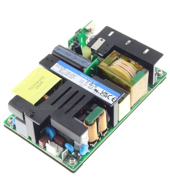

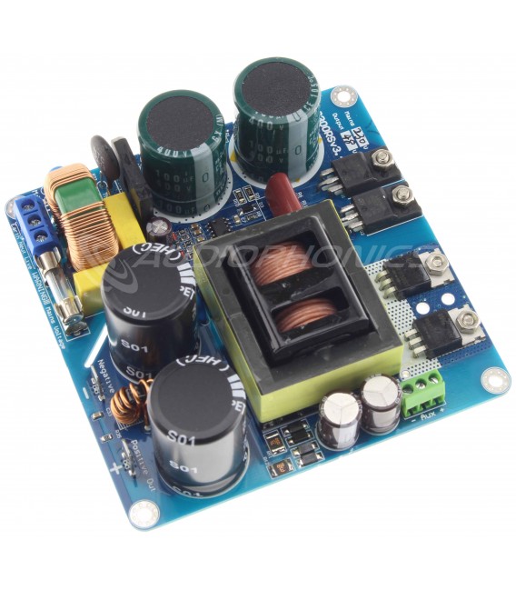

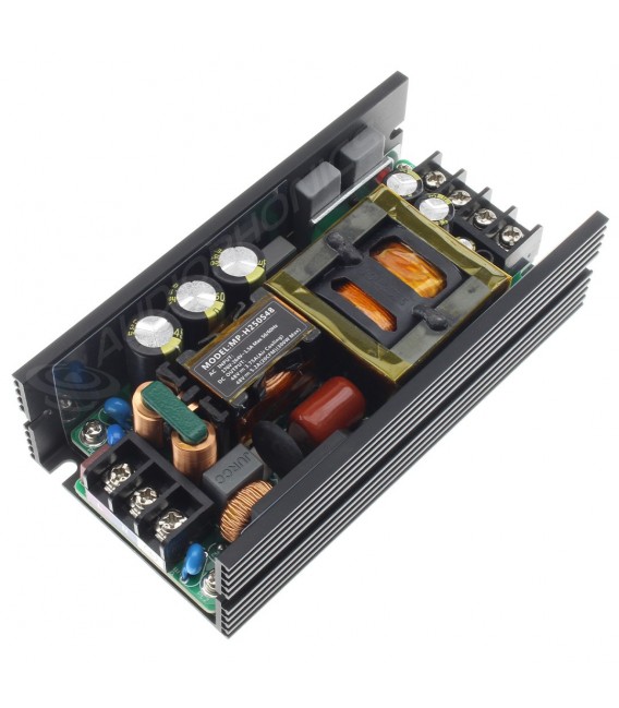

Concerning the PSU, for having participated in several DIY projects around the TPA 325X. I can recommend these 3 models:
