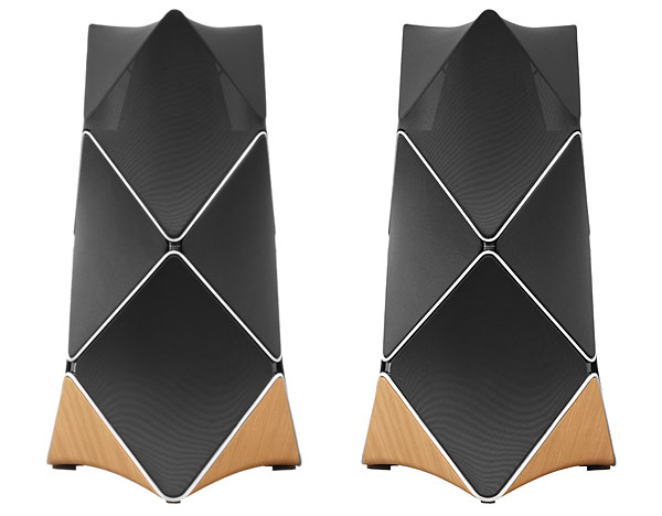

Nobody mentioned the Beolab 90.
There are these measurements. Seems like it’s a great option if that’s in your budget. Would be good to get subjective opinions against your JBL 4349 and Focal’s.
@Kal Rubinson reviewed them here:
Polars & dispersion on (page 17-19).
They likely cannot do 115db peaks at OP's desired distance. But their cardioid response, and flexibility to be able to go omni for background music, is perfect. Also, they look like art. I've heard them a dozen times. I think their "focused listening (narrow)" mode is lacking vs. dedicated hi-fi speakers. But they are versatile, so it's just a sensible trade-off.
But yeah I don't really see how you can hit the spl goals for that space without compression driver'd pro speakers, or, line sources.
Has OP considered JBL CBT1000? Would look quite nice with a refinish, and crossed to subs they can effortlessly do 128db in room. CBT too so should throw nicely.
