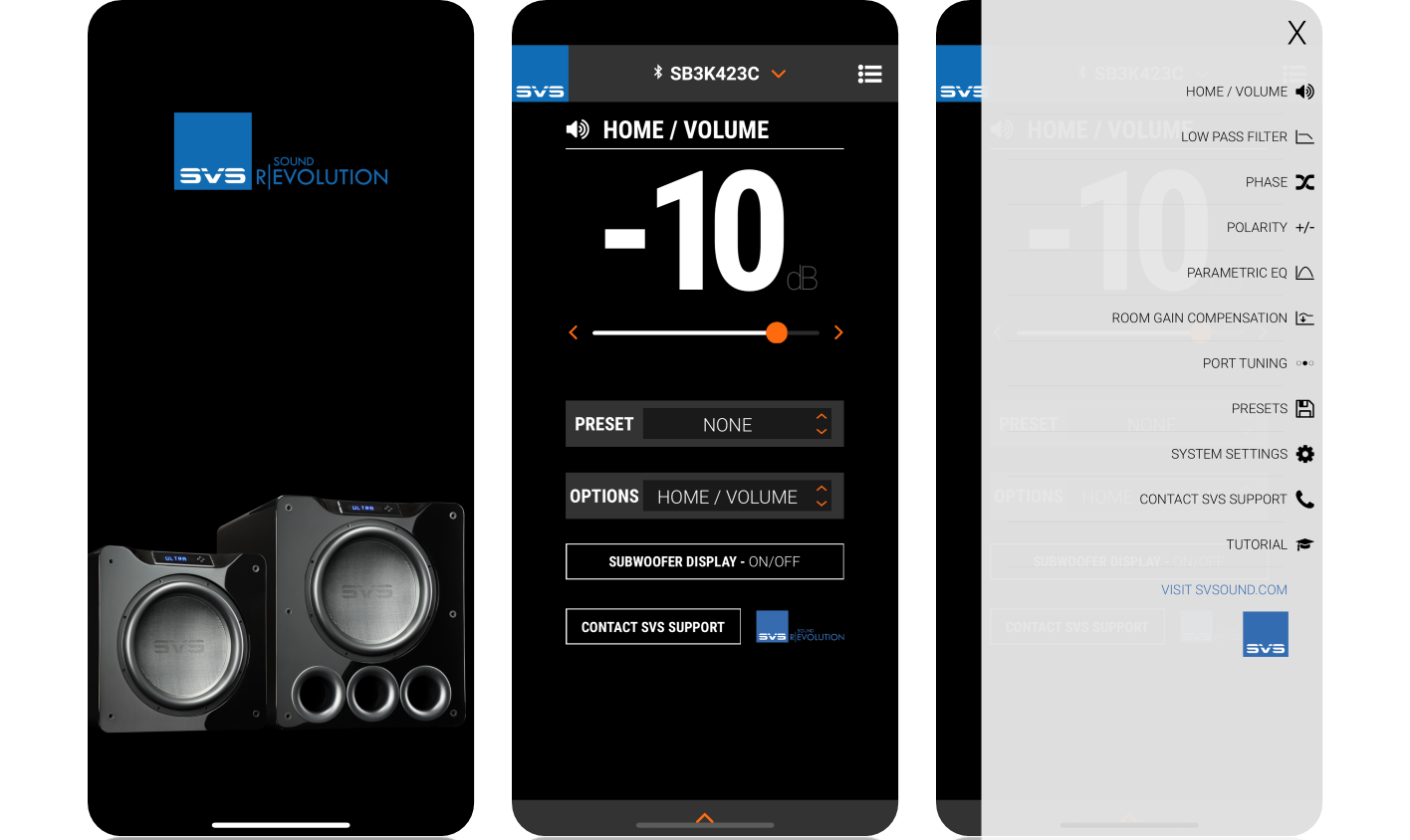

They both feature SVS’ built-in DSP with Bluetooth integration. This feature allows you to use an app from your phone - from the comfort of your seated position - to control volume, adjust settings such as high-pass filter, phase, 3-bands of Parametric EQ and other features. I really, really love this feature and it is, in my humble opinion, something that sets the SVS line apart from other subwoofers.

Here are some photos of the Bluetooth application:

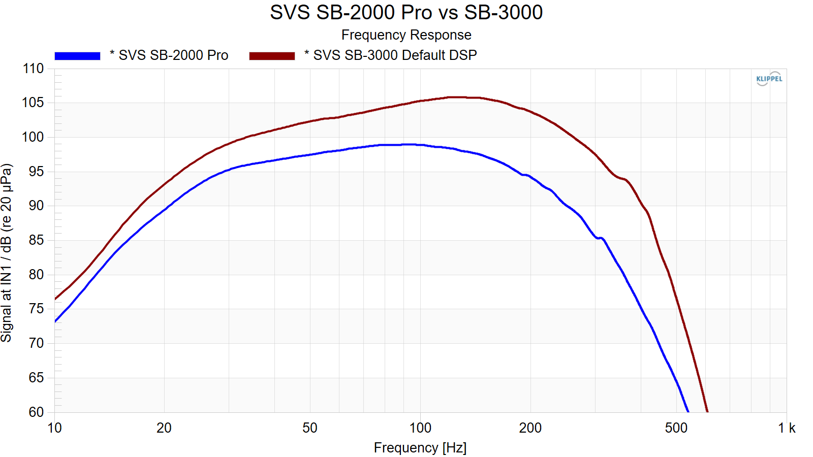

Frequency Response
The below frequency responses were taken with all DSP options disabled, volume at maximum and 0.05v RMS input in to the LFE channel. You can see the SB-2000 Pro has a more linear frequency response while the SB-3000 has a rise in the higher-frequency response until approximately 160Hz where both subwoofers begin to trail off.

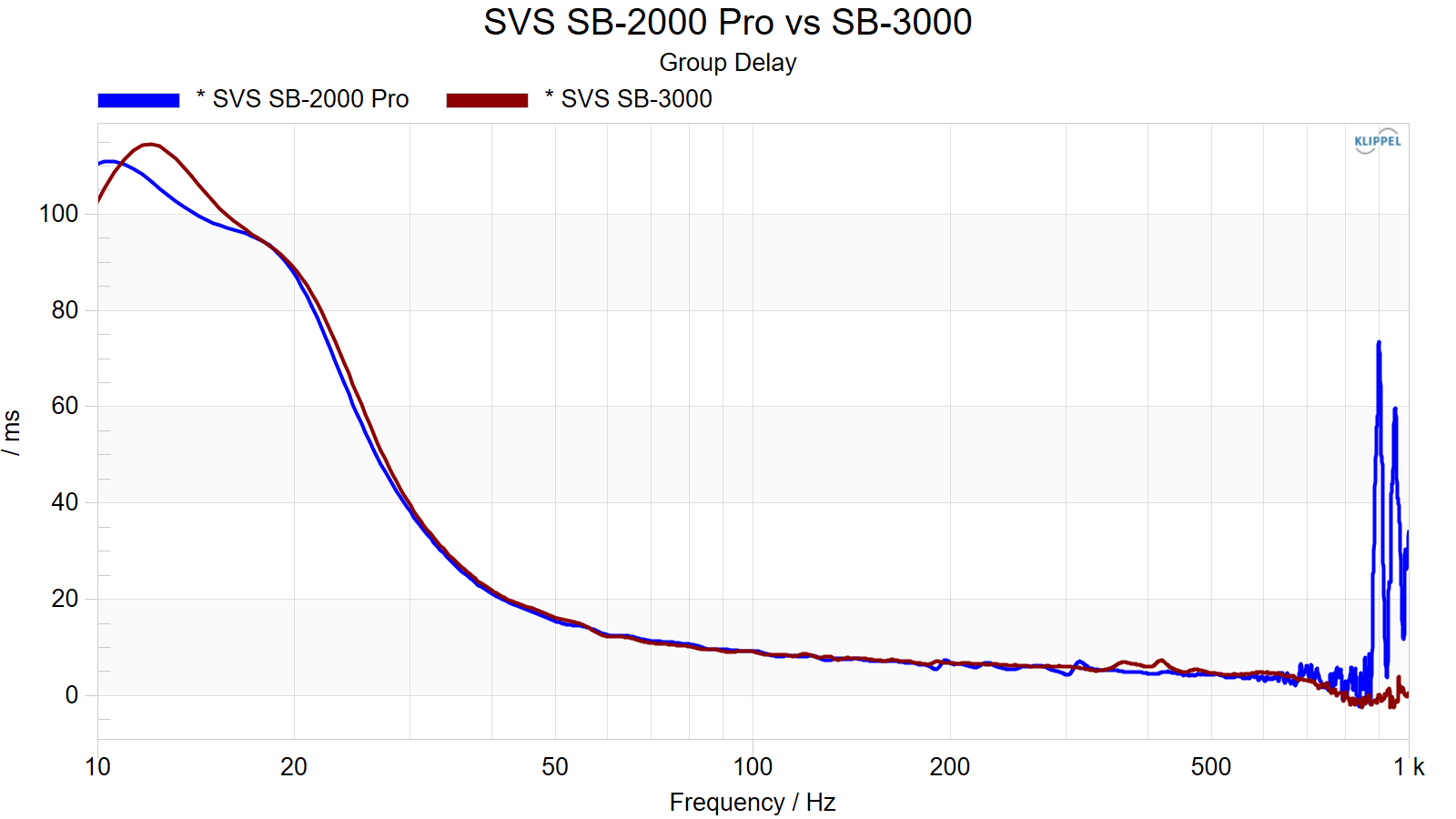

Group Delay

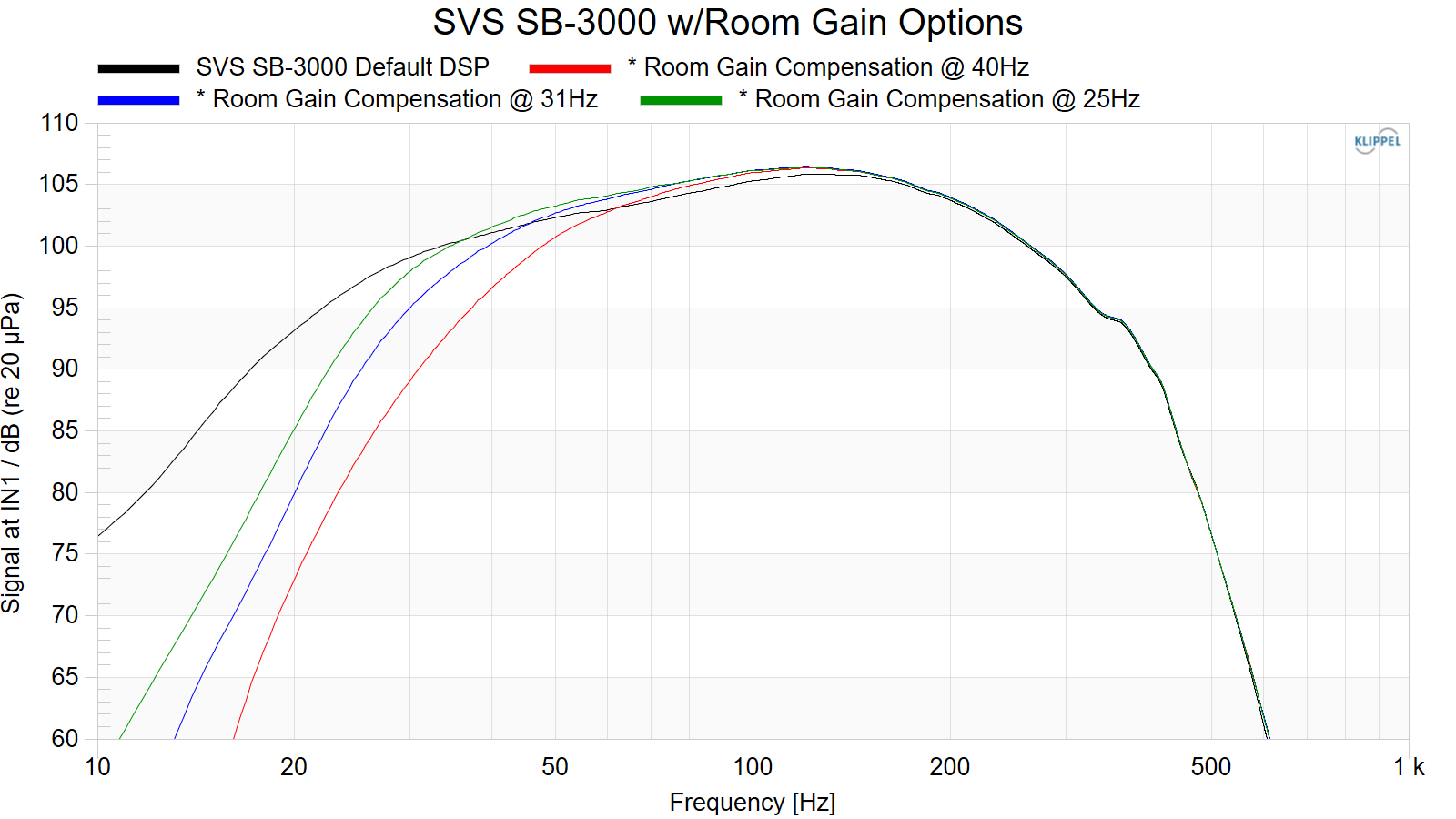

“Room Gain Compensation”
The below provides an idea of how the integrated DSP’s “room gain compensation” feature works. As you can see, depending on the chosen frequency, the low-frequency response is rolled off earlier than the subwoofer naturally rolls off. This might be ideal for those who have a very small room and get exaggerated bass or have neighbors who they do not want to bother with very low frequency effects.

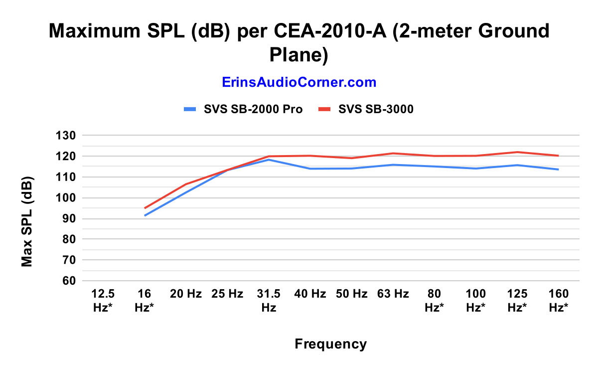

CEA-2010 Test Results
CEA-2010-A vs CEA-2010-B Foreword:
CEA-2010-A and CEA-2010-B are completely different tests with different distortion thresholds and therefore should only be compared to other like tests (A vs A, B vs B). To date, I am the only independent outlet providing -B tests so no worries there. Comparisons between my own -A and -B tests should only be made for educational purposes.
-A specification uses only frequencies from 20Hz to 63H in 1/3-Octave steps (20/25/31.5/40 Hz). Distortion thresholds are the same for each frequency. Other outlets have taken the liberty to use those same thresholds and apply them to frequencies above/below the -A standard. To provide a comparison, I have also done the same. However, note these frequencies below 20Hz and above 63Hz are not part of the CEA-2010-A specification.

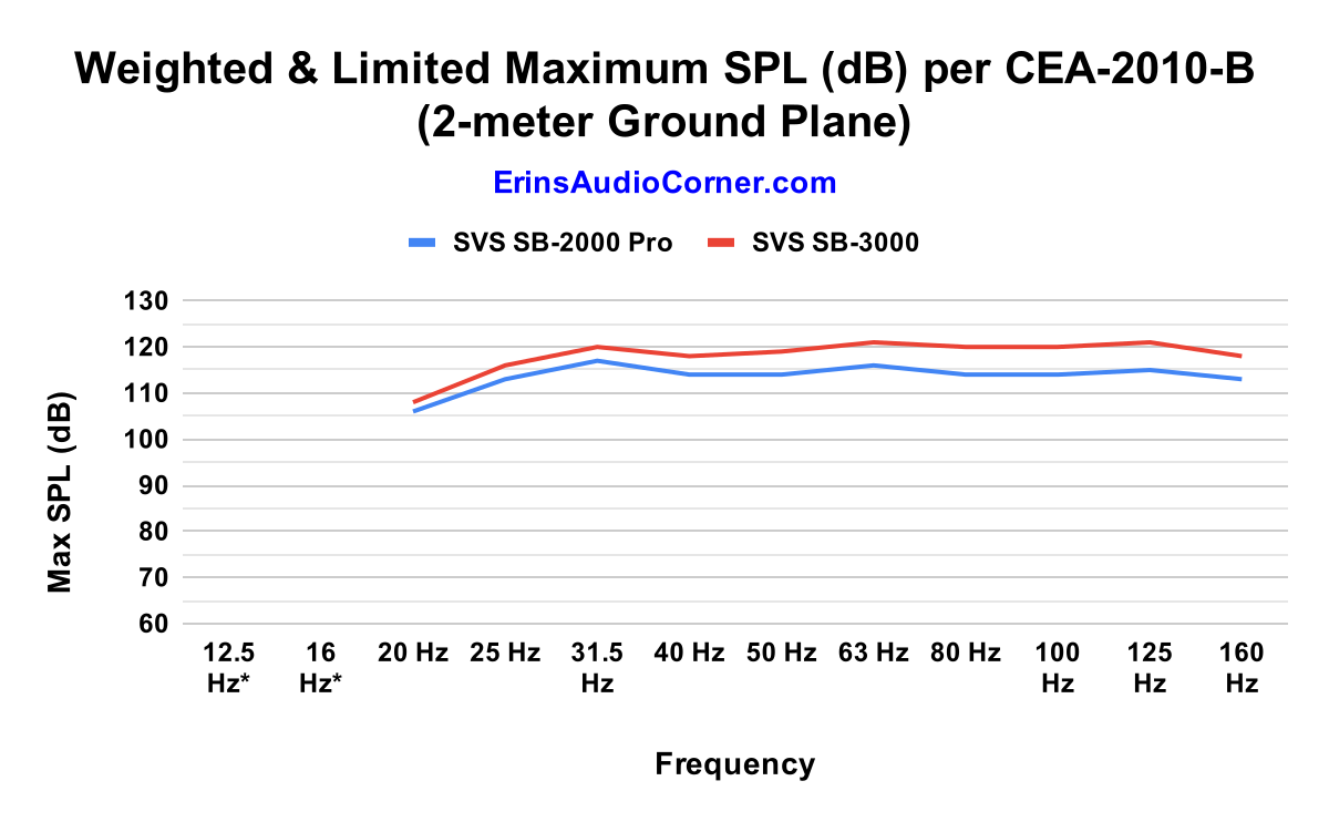

-B specification uses frequencies 12.5/16/20/25/31.5/40/60/80/100/120/160 Hz with varying distortion thresholds per frequency. More can be read about this in the CTA-2010-B specification. Peak values are obtained, then weighted per the spec. Maximum SPL values are provided for each frequency. A final “broadband” Peak SPL value is provided based on each frequency’s max SPL. While I have chosen to provide “extended” frequency results for -A (those tones above and below the specification’s called out frequencies), I am not doing so for -B because there is no reasonable way to determine what the threshold for those values should be. I believe those who wrote the spec to be smarter than me and I do not take liberties in adjusting specifications at will. You can download a copy of the -B specification here. The CEA-2010-A standard is not free and thus I have no freely available link.
All the following data is from my spreadsheet which can viewed directly here.
Weighted%20%26%20Limited%20Maximum%20SPL%20%28dB%29%20per%20CEA-2010-B%20%282-meter%20Ground%20Plane%29.png
In both test standards the SB-3000 provides more output. Per the CEA-2010-A spec, Above 31.5Hz the difference is approximately 5dB higher with the SB-3000. Below this, there is approximately 3dB difference. Per the CEA-2010-B spec, the difference follows the same trends. Both subwoofers display a lot of clean output potential.
Yes, my results for the SB-3000 are quite different from the results shown on Audioholics but curiously only below about 40Hz (IIRC). I can't explain why there is a difference here. I tested this speaker 3 times on 3 different days, once even completely wiping all the settings to make sure nothing was left over. My data stands.

Wait... the SVS SB-3000 has a 20hz 106.5dB CEA-2010(2m peak)?!!? Isn't that like... an absurdly high number for the size of that sealed sub? It's only 3dB less than the MUCH larger, ported Monoprice THX 12(THX EQ) @ 109.3dB.
Audioholics reported the SVS SB-3000 2m RMS as 93.6 which would be 96.6 2m peak, no? They reported the Monolith 12 at a comparable 106dB(which would convert to 109dB peak).

Yup. Like I said in the review...
This thing has a lot of output. I couldn't believe it. I didn't believe it at first. That's why I tested it three times on different days. And I even verified the mic calibration of my Earthworks mic with that of my Klippel mic. If you look at the results of AH and mine above about 40Hz, though, you'll see they're practically identical, IIRC.
Edit: I'm not sure what the discrepancy could be between mine and the dataset shown by Audioholics but since this is the only time I've had such a difference and it has been shown in a later post that AH's test was conducted on a day with 43°F temperature - which is not conducive to LF tests - I will leave my data up. If I do find an issue has occurred with my tests then I will make the appropriate updates/retractions. But, as of this moment I see no evidence to tell me the numbers acquired were not real.
So, yea... my results stand. ;)
Understood. Thanks for testing it so thoroughly. I admit I'm pretty puzzled. If the test is correct(and I'm certainly not saying anything bad about your testing, I know it's EXTREMELY thorough lol) that would mean the SB-3000 has comparable 20hz output to the MUCH larger Rythmik F18, and far higher output than any other sealed sub in its size class that I've ever heard of.
I get it, man. I'd question it, too. I mean, I did question it. But, three different tests on different days with completely different settings.

Isn't there some formula you can plot for acceptable group delay vs frequency? Is it possible to add that to the group delay plot?
