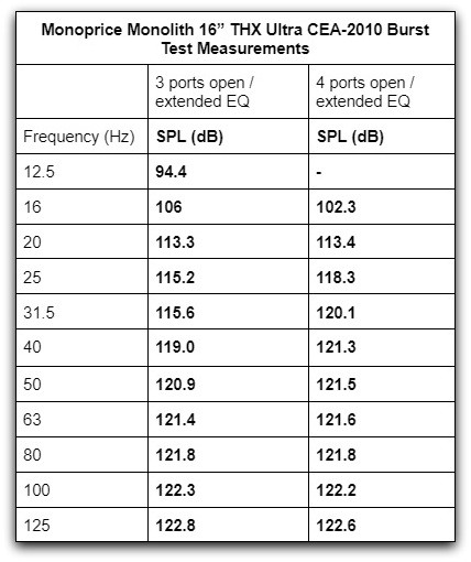

For the OP who manages the list, I wanted to share that the Monolith 16 THX Ultra subwoofer numbers appear to be incorrect, listed too high.
The Audioholics review that they were taken from was updated in 2023 noting:
"Note (7/26/23): Our initial CEA-2010 measurements were about 2-3dB too high due to a microphone calibration issue that was later discovered. We have since then revised the data table accordingly to reflect the actual output capability of this subwoofer more accurately."
Updated chart shown in the review.

Can you please update your MONOLITH subs on your Spreadsheet, as Audioholics had a microphone calibration issue they later discovered and so they changed ALL of their measurements on 7/26/23. Thanks

Heres where Audioholics revised their measurements on all Monolith subs. Please update your spreadsheet as its got false readings currently.

The Monolith Subs were ALL given incorrect numbers. Audioholics who did the testing made their error public yet some Speadsheets like SweetChaos that your referring to still have the outdated wrong measurements.
Also all of those measurements are inflated by 3dB from the source which use Anechoic data. So make sure to double check the numbers from the actual sources.
