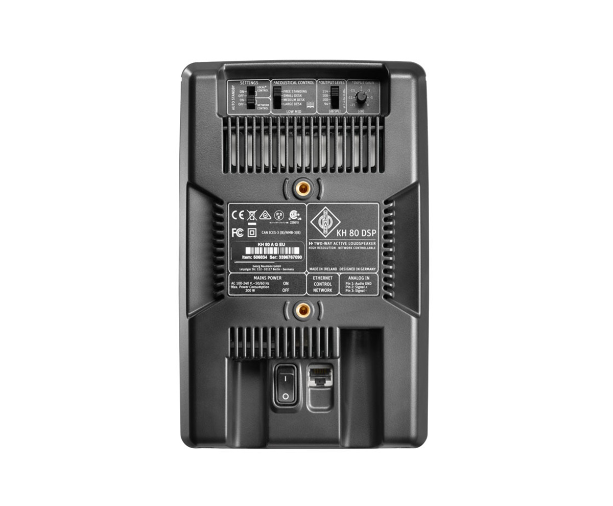

Can we have a list of overhead speaker?
There seem to be very few speakers with mounting holes on the back like this?
I know 3 types of speakers that have mounting holes:
1. Studio monitors.
Higher-cost models usually have some kind of mounting system.
Lower-cost models may or may not have mounting systems.
Example: Genelec 8030

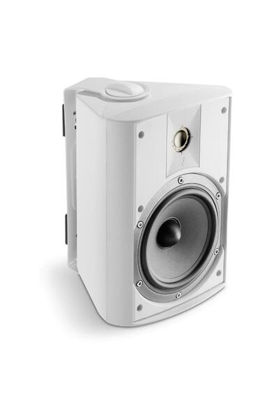

2. Outdoor-type (waterproof) speakers, which usually have a mounting system.
Here's the ones Amir reviewed:
-Revel M80XC
-JBL Control X
-Polk Audio Atrium 4
-OSD Audio AP650
-RSL Outsider II
-Focal Chorus OD 706 V
-Revel M55XC
Example: Focal Chorus OD 706 V

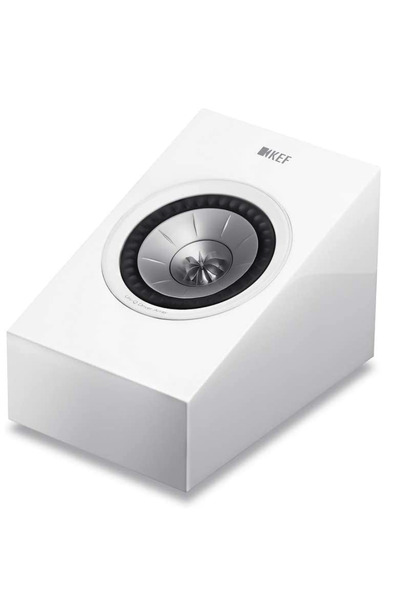

3. Atmos-style (angled) passive speakers, which usually have a mounting system.
Examples include:
-Kef R8A
-SVS Elevation
Example: Kef R8A
