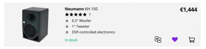

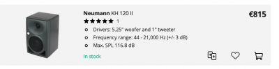

Hi! So what about KH 120 ii vs KH 150? Whats the difference apart from price, cone size, and tiny lower frequency response?
The price difference is quite huge compared to the differences?

The pricing is typical. Just look at the JBL 7 series.
Not really, €630 difference each, see screenshots from Thomann EU
On thomann.de the Genelec 8340A is about 67% more expensive than the Genelec 8330A, and that is similar to the about 77% between the two Neumann monitors.
