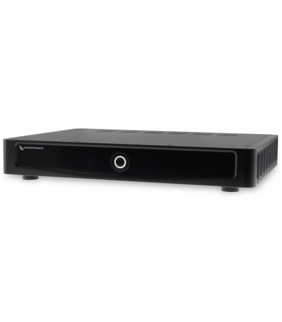

Audiophonics is now selling a stereo Nilai unit with dual mono power supplies. It appears they have discontinued the single power supply stereo unit - too bad, I really like the Audiophonics case for the original stereo model.
Bummer to hear about your experience. I understand wanting to send it back..it shouldn't be so complicated to slide the top back on. If you give it another go try loosening the feet as well. I'm just going off memory though.
When I get home & look at it I'm sure I'll recall what I did to slide the top in. I'm guessing you popped the top to switch gain? Did you get a chance to listen at all? I'll trade you a nicely put together stereo version for your 3/4th put together mono blocks lol.
Maybe just step away from it for a couple hours or til tomorrow & give it another go..unless you already know it's not for you. I've had frustrating moments with audio gear in the past. No fun. Good luck
I did step away. I have it at high gain. I'm listening with the tops off. I'm so pissed I can't enjoy it. Thanks for your help. Give it a go after work tomorrow. Gtta see if there's enough difference between the NAD 399 and Nilai to justify it.
That does look sweet!
The Audiophonics case top can be a little finicky to re-seat properly, but it's a 1-2 minute job, not a 4-hour one.
