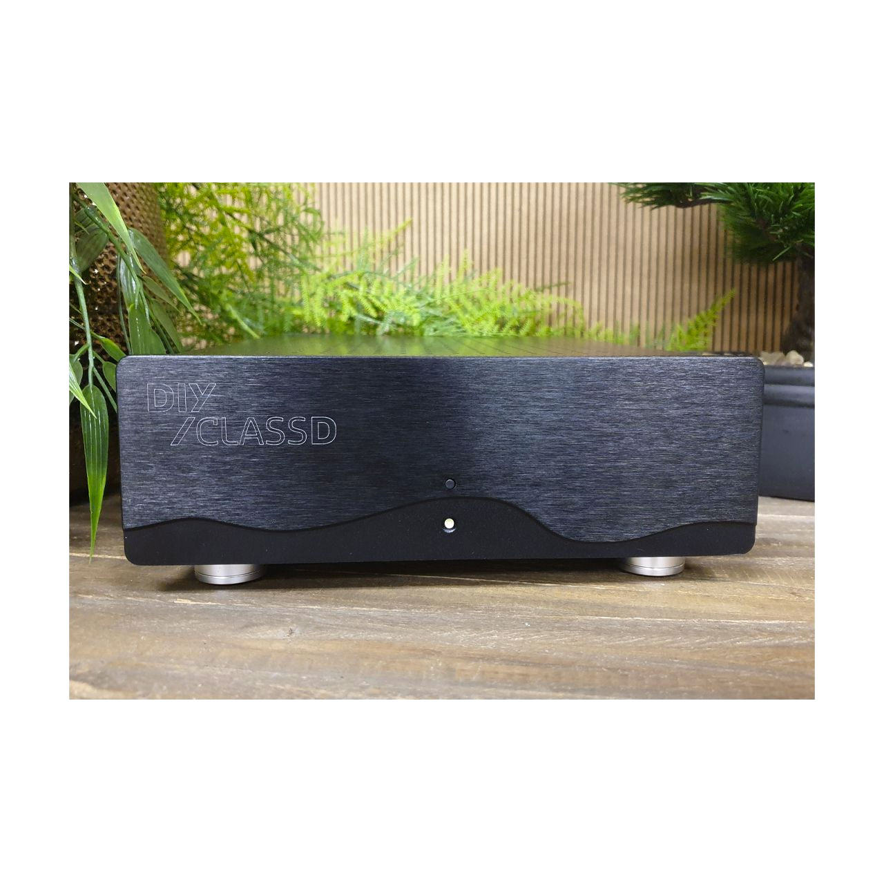

Here are external pics...
Along with a status LED, the front panel has a (smallish) standby power switch. The IEC power inlet is fused and the amp has high quality binding posts. A trigger input is included and Hypex moved the LED brightness control to the back panel. The case has been redesigned (from the previous clamshell) and allows simpler access to the internals (notably the gain jumper setting).
