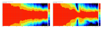

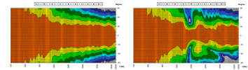

Neumann provide measurements of both versions on their website: https://www.neumann.com/en-us/file-finder/
I downloaded their graphs, scaled them to match, then overlaid them for easy comparison.

Directivity (top=KH120A):
KH120A has very slightly wider directivity in both axes, but vertically it's less controlled.
