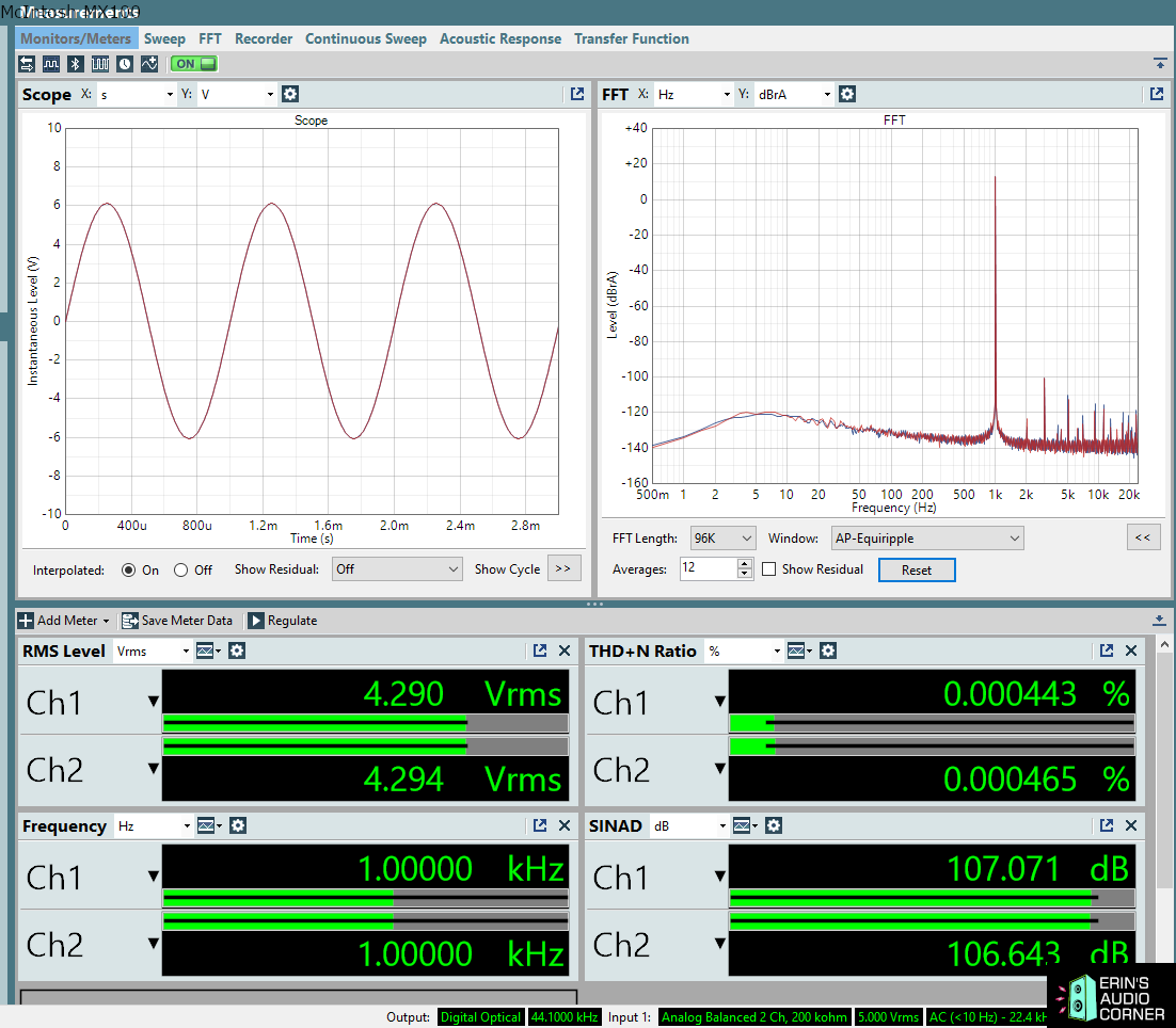

ErinsAudioCorner has posted his first electronics review using the Audio Precision APx555B.
:D
The rest of the graphs are on his site.

Looking at the specs, and now measurements too, it almost seem like the MX100 is a clone (a much better version) of a Denon AVR, or maybe a Marantz AV8805A.:p
Don's see how this is much better. I also see no point in using a minidsp with this. Just buy the AV10 when dirac is important top you and be done with it.
I have red those coments in many other forums, particularly with users that have taken pictures of the layouts. However, I guess there are just so many ways to build an AVP with certain features. Mac and SU have never said anything at all, but on the other hand Mc has never said anything about Hypex on their class D amps, yet, users over here have confirmed that those are indeed Hypex modules.
If we see a new round of processors by fall with similar features to the newer Denon and Marantz, well... :D
I was just joking. However, the distortion specs and the SINAD vs output voltage curve looks indeed very similar to that of the AVR-X8500H Amir measured. That must be just a coincidence though.
That being said, if Denon would just remove the power amps from the 8500 or the new A1H, replaced the 25 to 30 lbs power supply with a much smaller one, and add balanced output, it will be an excellent much lower cost alternative to the high end preamp processors, such as McIntosh's.
