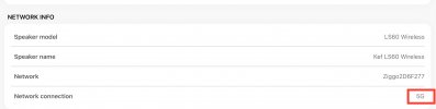

I may have found a solution for the slow wifi speed causing drop outs on my Kef LS60, by disabling the wifi 2.4G setting / band on my router.
Will check the next days, but everything seems better now. The LS60 connected to the 2.4G wifi of my router, which also sends 5G wifi. By disabling it, the LS60 now selects the much faster 5G connection. You can’t select it in the kef app yourself.
