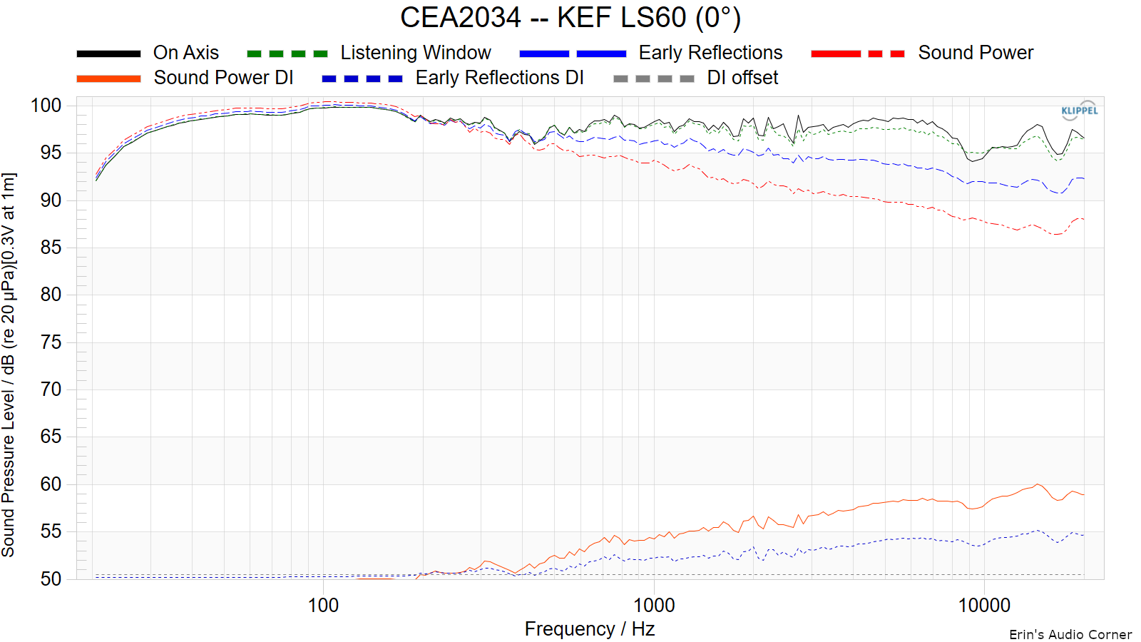

Erin has reviewed the Kef LS60 Wireless. :)
Video review:
Spinorama:
The rest of the graphs:

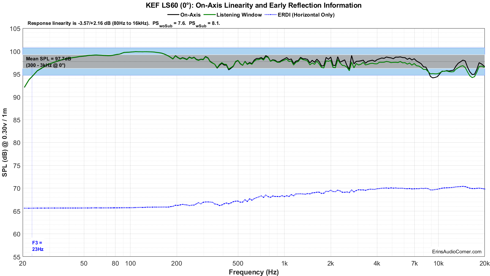

Erin's calculation:
Preference Score is 7.6
Preference Score wSub is 8.1
F3 is 22 hz

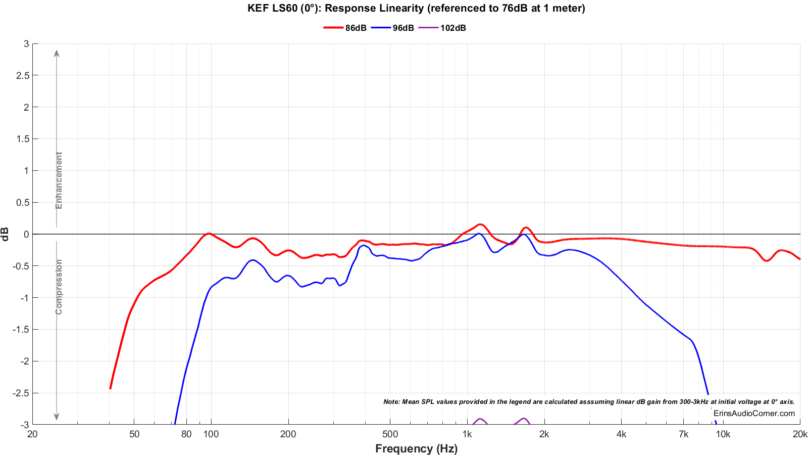

In really disappointed with the compression measurements. Based on KEFs data in the white paper I expected it to roll off the bass but at least attempt 102 dB @ 1m above there. Even the ls50 wireless does better in output.
But it doesn’t go down to 23Hz and it has more distortion at low frequencies. There is no free lunch. Pick your poison. The LS60 is still a small speaker meant for smaller rooms and for that it does excellently.
I understand it has more bass but I'm underwhelmed with its output above 100Hz considering this data from KEF and that it's a 3 way speaker.

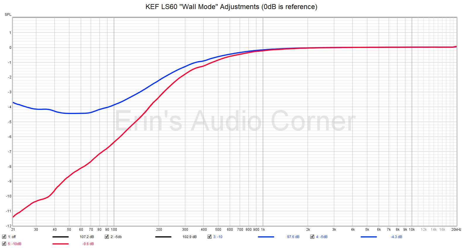

This speaker really has plenty of loud bass, room gain helps big time. I have “wall mode” on -5.0 db. But you can also use 1 or 2 subwoofers to increase bass headroom.
Where my kef R5 were lacking so much bass that without a subwoofer it would be useless to me, the LS60 hasn’t once triggered me to add a subwoofer.
I guess you're into hearing damage then? Even 90db over a period of time causes hearing damage. I find 80-85db to be the about the most I care to listen at. There's nothing to not like about these speakers when used as Kef intended them to be used for.
