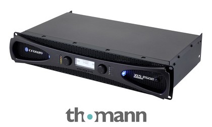

Why not connect a Crown XLS to the pre-out of your Denon?
Given the sensitivity of your main speakers, any noise from the amp would likely be negligible. You’d get the power you need. It doesn't have trigger in though.
