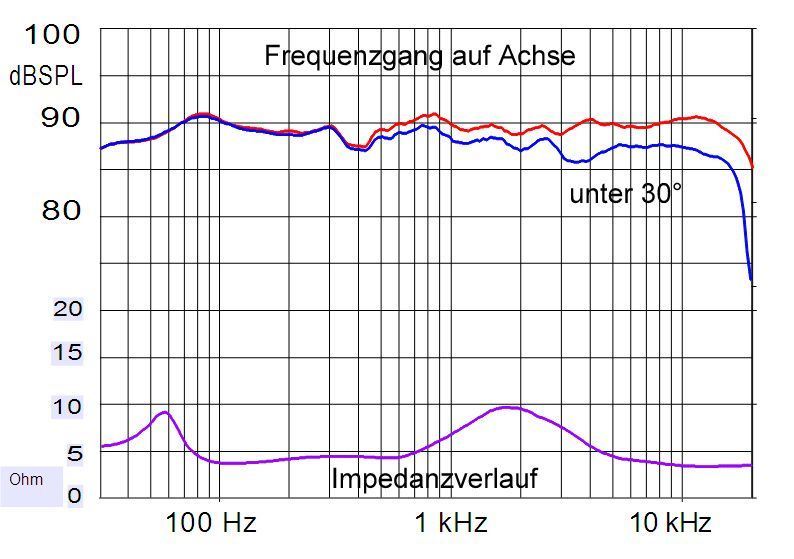

I run a WIIM AMP PRO on a pair of Triangle Australe EZ.
I'm fine with my setup, but always looking for improvement. So I came across the recomendation to raise power to at least 120 W or even 150 W in order to get the best outta my speakers....
I started to Google about it, asked AI and the manufacturers, got many different explanations and ended up confused.
The speakers have a labeled sensitivity of 92 dB/W/1m and 8 Ohm with a Maximum at 9.5 Ohm and a minimum at 3.7 Ohm (should be labeled 4 Ohm, right?). The amplifier delivers 60 W per channel at 8 Ohm, was very well reviewed here and some of you will know it.
The link below leads to some measurement of the speakers:
What do you guys think about it? Will a stronger amp improve the sound?
Thanx Chris

As for power, you 'need' about 5 watts for 80 db at 3m with plenty of headroom available. To account for musical peaks, get 20db of headroom. Now you need 57 watts.

That means you're using less than 1 Watt of power per channel. Add some generous safety margin for peaks, and it's like 8W. Your amp is fine, there's exactly nothing to gain by getting more power that you don't ever use anyway.
