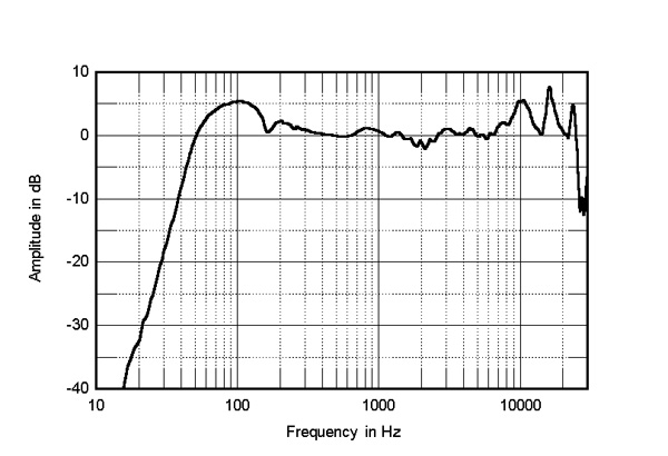

When I look at the A170 FR at stereophile, I can not help but notice the big differences between A170 and A130.
Around 1K-2K, A170 has a dip; A130 has a peak.
Around 10K-20K, A170 has 2 peaks; A130 has only one peak.
Would the differences cause very difference sounds?
I would assume that A170 and A130 use the same tweeter and woofer, or at least similar if not exactly the same. Then why the FR are so different? A170 is not looking good.
Stereophile measurements for speakers are not very good. They show an artificial boost in lows and are averaged/smoothed a lot. I would not compare them to my measurements and draw any conclusions.
Good to know. Thanks. I also found their measurements for other speakers a bit odd. Guess they have a lot to consider other than the data.
