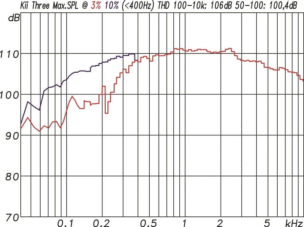

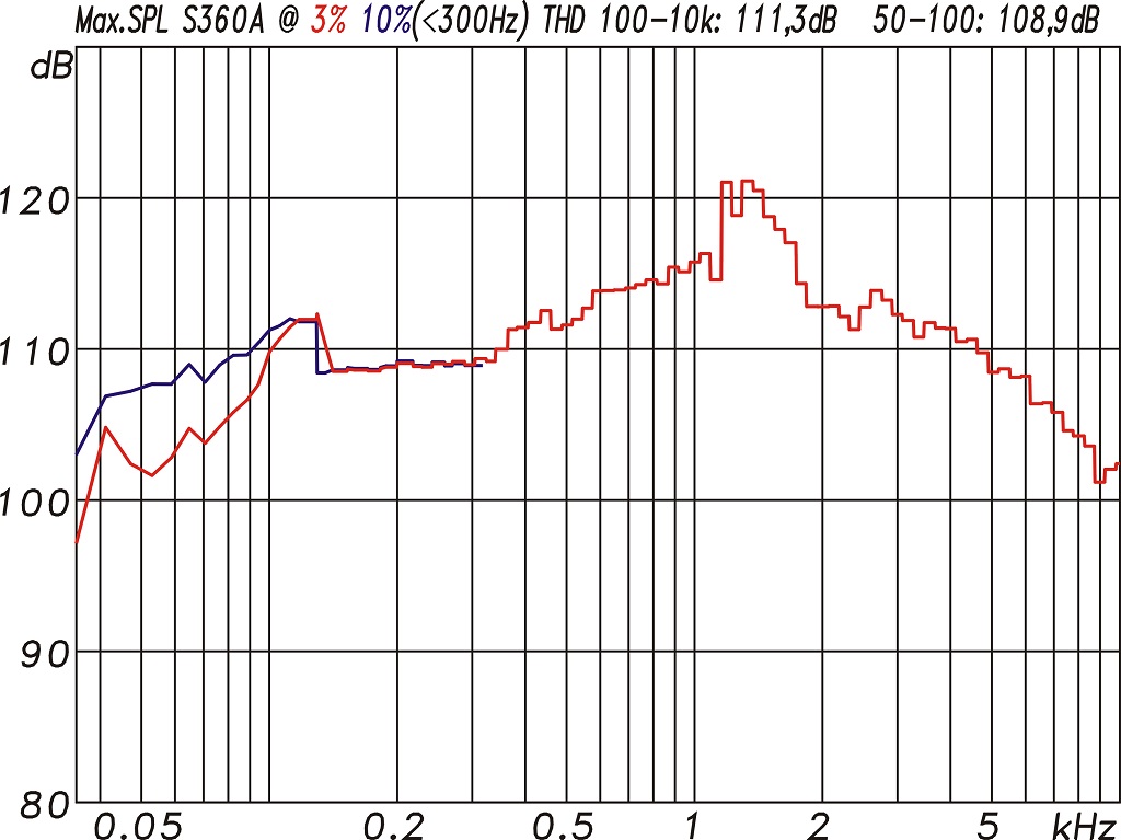

Anselm Goertz has measured and reviewed 8361A for Sound & Recording. Review available here (Genelec website):
https://images.ctfassets.net/4zjnzn...elec_8361_testbericht_sound_and_recording.pdf
Thanks a lot. Here are some similarly priced and/or sized monitors to appreciate the fact that the 8361A isn't gimped in LF:
index.php
Except the ~150 Hz (tiny) dip it compares favorably to the KH420 in bass! That tweeter doesn't seem to be that good, though. Just hope the 8351B follows its trend.
