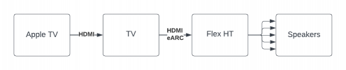

Am I fooling myself that any (upstream) device to make use out of miniDSP flexHT needs to have dual (2x simultaneous) HDMI outputs?An automatic hdmi 2.1 switch in front of this one to allow for expansion
Here's one possible setup w/o the need for dual HDMI out:Am I fooling myself that any (upstream) device to make use out of miniDSP flexHT needs to have dual (2x simultaneous) HDMI outputs?

I agree. I got a Shield Pro for my LG tv about 2 or 3 years ago because the LG tv did not do DTS. The Shield Pro converts DTS to LPCM. The chain would be the diagram above by staticV3, except the Apple TV is replaced with the Shield Pro, and only gives stereo. I only use stereo when I do this.I do believe the Shield will decode and output LPCM. What a great device. Mine is still going strong from 2015 as our bedroom Kodi box.

so exactly what movies will output 5.1/7.1 LPCM from Apple TV so that I can use the flex HT for 5.1/7.1 dirac live processing??Here's one possible setup w/o the need for dual HDMI out:
And in case your TV doesn't have an eARC port, you could use an HDMI eARC extractor to send the video to your TV and the audio to the Flex.
They're inexpensive little boxes.
All of them. Anything that is not Atmos is already output as LPCM and if you change the settings to 'Atmos off' any Atmos encoded films will be output as 7.1 LPCM.so exactly what movies will output 5.1/7.1 LPCM from Apple TV so that I can use the flex HT for 5.1/7.1 dirac live processing??
Looks like the Flex HT would be winner for my situation then. I can still use my node to stream music over its digital outputs to the Flex HT and use Dirac Live room correction which will definitely be a step up from basic sub crossover that comes with the node.All of them. Anything that is not Atmos is already output as LPCM and if you change the settings to 'Atmos off' any Atmos encoded films will be output as 7.1 LPCM.
