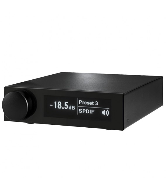

Coming soon: MiniDSP Flex with HDMI input
Ah, so you are looking for an HDMI in/out version of the 4 channel Flex. Send MiniDSP a request. You never know……
it seems one could easily do this with existing hardware, but it would not be a one box solution.
My main application is to use windows/mac laptop, or desktop and JRiver. Can actually get by without the hdmi output, but it would be nice to have that option too, especially for my DSD files.
There is no problem with 8 channels, that is > 3 channels, but I am not willing to pay for 8 channels when I will never use more than 3 (okay may be 4 if I want to add a second sub) channels. About the space issue, there should be room to add HDMI out if the DAC has 3 to 4 channels only. The micro HDMI connectors may also be an option.
Same, would love to see a decent four channel usb DAC for 3.1. Not many options currently...thinking Motu M4, Sound blaster x4 or maybe two DACs, like 2 x PO100.
Standard flex is 4 channels with a USB input?
Any chance they will also offer a 3, or 4 channel version so people who only need 2.1 (a true 2.1 using the 3rd channel for the subout) don't have to pay for 5 extra channels that will idle from day 1 to day infinity...? As far as I know, no one is doing a 3 channel dac with HDMI input that can be used with Dirac Live DLBC PC standalone version. I have been searching for one before I pay for the DLBC license. There are the likes of the MOTU M4 but those are really for the pro applications.
The product is niche enough as it is. Adding another version, supporting it, writing software for it, adds cost. For something that is even more niche and sells in the tens of units. That will drive up the cost like crazy, far more than having too many channels.
I mean, why are AV pre amps far more expensive than the much more capable AVRs? Economies of scale.
We can all be glad that there is even going to be the Flex HT... there's a reason why no other company is developing something like that.
I just received a response from MiniDSP that despite having the HDMI eARC input "Flex HT supports eARC but no auto ON/OFF feature." I was under the impression that eARC functionality would imply basic CEC support for putting the device in and out of standby. So i'm confused on how the Flex HT is supposed to be cleanly integrated into a home theater system when you still have to use its own remote to bring it out of standby, save for leaving it on constantly.

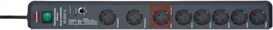

You could use a power strip with Main/Follow, or sometimes called Master/Slave function:
The TV is plugged into the Main socket, and once its power consumption drops to standby levels, all Follow sockets are switched off.
When the Main power consumption increases, all Follow sockets are turned on again.
You may want to make sure though that the Flex HT turns on all the way when power is restored, instead of first going into Standby.
I've definitely seen these, but I'd really like to avoid forcibly cutting power to the unit on a daily basis, that seems like a recipe for problems... are you currently doing this for your Flex?
I do not currently own a Flex.
I do that for my Genelecs 8050/7070, and a lot of other components. I have been doing so for about 20 years. With zero problems. Pre/Pro to standby and rest will stop getting current. Wake up the pre/pro and speakers turn on.
