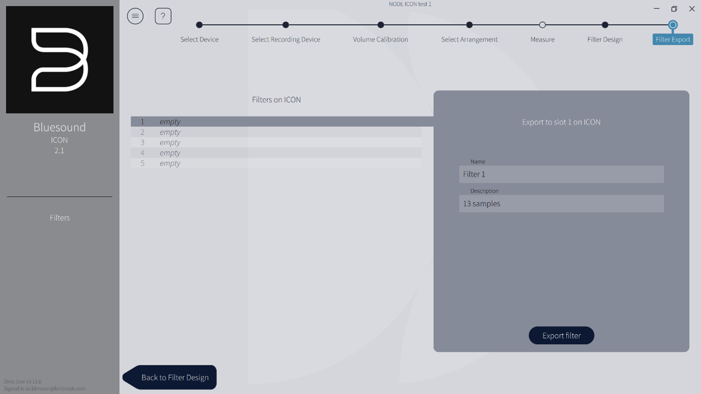

Just tried dirac but i have not a good mic yet so I used my mac internal mix. Résultat is really strang but I guess it’s the mic’s fault. I’ll buy one next month and ask a friend to help me calibrate the speakers. Because I’m not a pro and it’s quite hard. One thing I noticed is that when sending the frequencies test my left speaker as a sort of crackle in the Bass and nothing on the right really strange
An internal mac mic is definitely going to give you funky results. It's essential to use a good, calibrated mic.

Thanks i will buy a umik 1 next month. Yes the result are strange like it sounds way too much on Bass on the sound is like restrained
If you hear crackles ON the sweep your volume is too high.
What you can do is to adjust the target curve to match the measured native response and just smooth in the peaks and dips. Even if your mic is miscalibrated, it is precise but inaccurate and can be used to address the worst parts of your frequency response.
OK gave Dirac a shot with my UMIK-1. I guess I have a steep learning curve to climb as after measuring several times, each time the result just seems to knock out the bass, sounds very flat. Will have to try again tomorrow after some more reading.
Bluesound Icon -> Buckeye Purifi amp -> LS50 metas & SVS-3000 Micro sub
You don't have to recalibrate each time. Save the calibration as project. Try using different target curves. You can also use the sliders of the auto target curve function to adjust to your taste: Link

The standard “Harman” cinema curve is as much as a 10 dB bass boost.
Bluesound’s target is https://www.bluesound.com/usa/amfile/file/download/file/3574/product/1087/
What you want to use is the different presets to have a flat, Harman, and then can try the Bluesound target too.
EDIT: Take a screenshot of your final measurements post measurement and we can help.
Yea that sounds like it should be solvable by adjusting the target curve.
