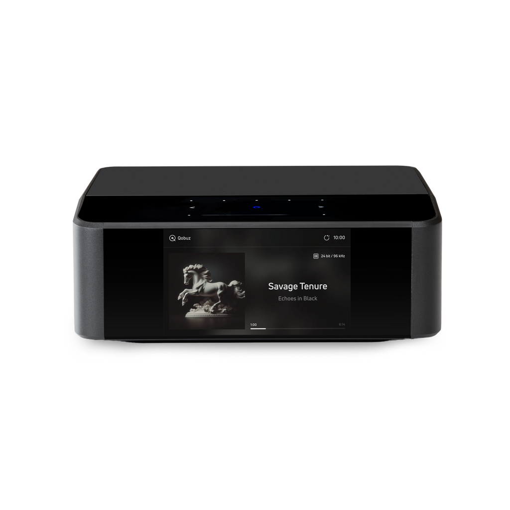

This is a review and detailed measurements of the Bluesound Node Icon Streamer, DAC and Preamplifier (ADC). It is on kind loan from a member and costs US $999.
Bluesound Node Icon Streamer DAC Stereo USB XLR preamplifier adc mult-room wifi review.jpg
I can't say I am overly impressed by the design as it kind of looks plasticky. There is a nice large display but doesn't support touch which is strange in this day and age. Instead there are a set of touch buttons on top. I did not use any of this and instead of downloaded the BlueOS app. I found it super confusing, taking me almost 15 minutes to figure out how to change inputs! The option is not under "Audio." Nor the "Player." Instead it is under a "Music" button on the bottom! Half hour spent doing usability testing would have shown them this to be an issue. I understand it supports Dirac but I did not play with that. I updated it as it requested on first connection.
