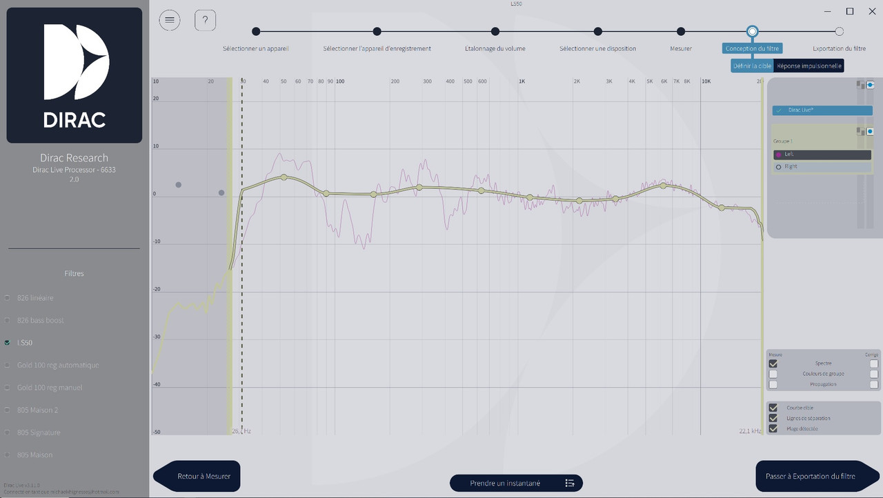

Hello, here is a measurement of LS50 and a homemade target curve to keep the character of my speakers.
This is the dirac plugin on computer but it is certainly the same for the node.
Made with a umik 1.
This is to show an example.
