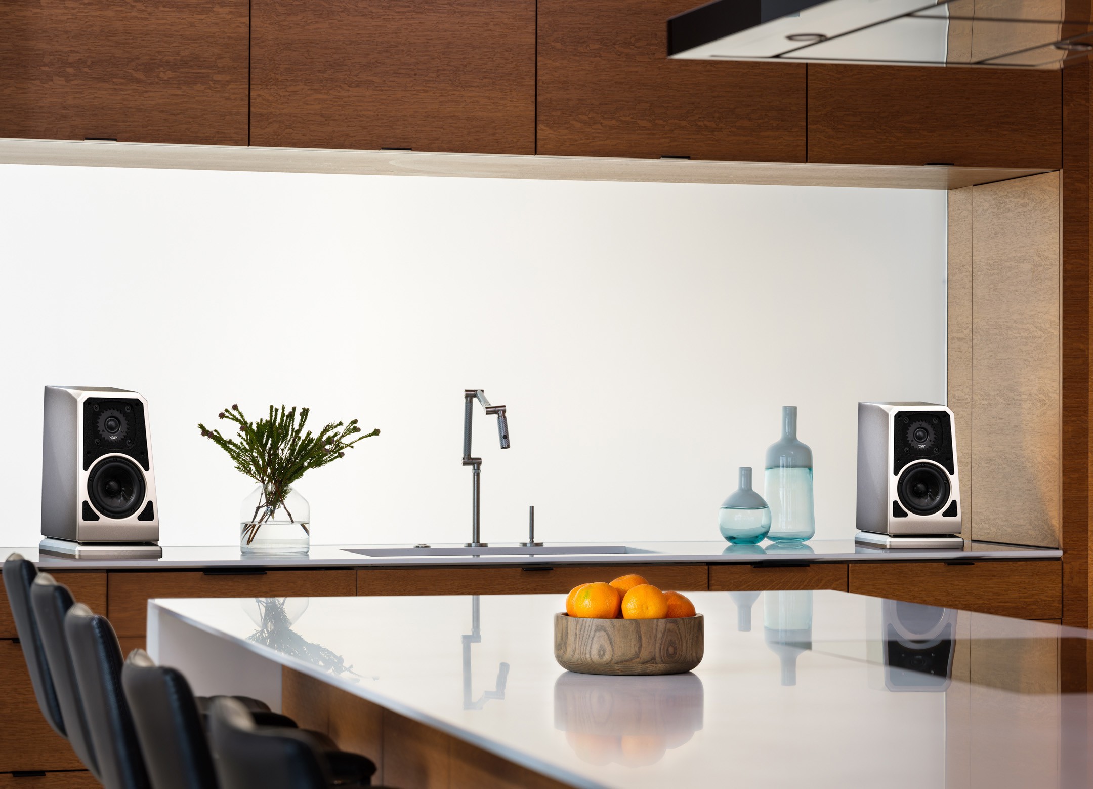

What's not serious? How far do you think people pull out their speakers from the front wall on the average?
This is company marketing picture for this speaker:
Looks a heck of a lot less than 4 feet to me.
Nice faucet!
I think the water flow could be made less turbulent if it was equalized.
