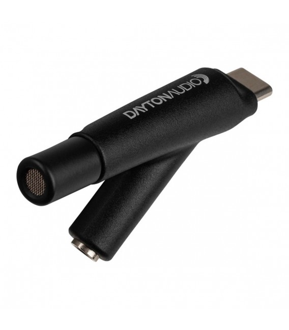

I agree that the Room correction is a great feature, but the fact you can't use an android phone to do the measurements will not cripple it's market, imo. Using a separate usb-c mic is going to be possible soon and that is a much better solution anyway
"Using a separate usb-c mic is going to be possible soon" Where have you read this and is the separate usb-c mic going to be sold by Wiim? because otherwise you have the same problem as with Android devices... many different usb-c mics
It is currently not clear to me whether "external microphone" and "WiiM Remote microphone" are referring to the same thing.
I would assume it would be limited to USB-C mics with available calibration files.
your phone- tablette etc..and wiim home
