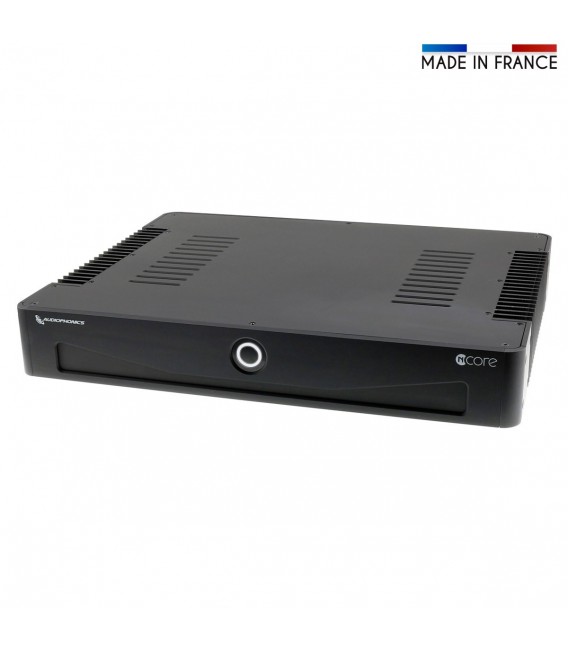

I don't have a new AVR or an amplifier yet, I'm waiting for the Pioneer flagship. But the amplifier on the LR should be one of these two:
Plus one equivalent monoblock. But I prefer Ncore for performance and price.
