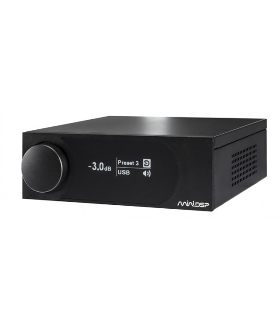

Ideally with optional Volumio, headphone output (and amp), Dirac Live® (or ARC), and a DAC.
So, depending on options, it would be an alternative to the Flex and/or SHD Studio.
I think there’s also a market for a neat, no-nonsense, domestically friendly answer to this question.
I always thought that the flex digital was the nail in the coffin of the SHD studio... wasn't it, sort of?
Probably.
The OP there was after a non-DSP (except volume control) digital pre-amp though. Which turned out to be quite rare, especially decor/family friendly ones. He eventually went for one with DSP, paying quite a bit for a whole range of functions he’s not least interested in.
