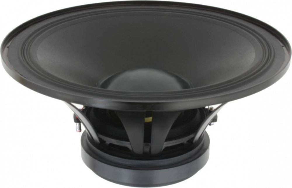

I don't have idea, because I don't have experience. His OB have 8x 18 inch AE Dipol and 8x 12 inch AE Dipol. If I good remember these OB have 14Hz with -3 or -6dB.
Having a dipole that low doesn't make any technical sense at all.
Below the first room mode there are no benefits anymore, the whole room basically becomes a pressure chamber.
