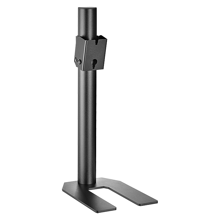

Ordered the LH65 stands, assuming (MY BAD) that they'd work for KH120 II
No. They've changed the mounting size from an M8 on KH120 to an M6 on the KH120 II
So now need to buy some more M6's. Not the biggest issue in the world but a PITA none the less
Now I feel like an idiot

IIRC, my LH 65 came with both sets of screws.
I must have gotten some old stock then before II was released. Not many stores in Australia stock it.
Foam had deteriorated pretty quickly when took it out of the box
Ordered M6 bolts on Amazon, so be here tomorrow. Not end of world.
Edit: Yep, I must have gotten old stock. I looked at the pictures online and they're different to the design of mine.
They're this design
Not this design
