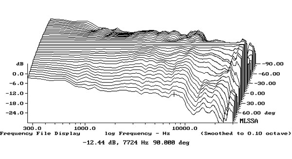

And Stereophile reviewed the much older, early generation version of this speaker, the Silver S2, back in 2003. The S2 had major resonances from the midwoofer that weren't well suppressed by the crossover. You can definitely see the improvements in the new model.
Monitor Audio Silver S2 Stereophile Measurements

https://www.stereophile.com/content/monitor-audio-silver-8-loudspeaker-measurements (5th gen)
https://www.stereophile.com/content/monitor-audio-silver-300-loudspeaker-measurements (6th gen)
(unfortunately no directivity measurements but could be even better due to the even smaller mid)
Doesn't look that different from the predecessor Silver 1.
