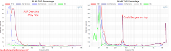

Is there any chance the 5k resonance is a loose screw/part/terminal plate- not driver related?
Wouldn't that show up in THD as well?
Edit: E.g. from the ASR Directiva review:
I don't know. Klippel is pretty smart and @amirm knows it pretty well. It can exclude a bunch of stuff in processing I'd expect. Say the mike (mic) is right in front of the driver doing its thing and the rear terminal plate is vibrating to the stimuli. It will be delayed and maybe excluded.
It is not showing up anywhere else so hard to explain it.
