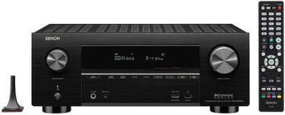

This is a review and detailed measurements of the Denon AVR-X3600H 9.2 channel AVR. It was purchased new by a kind member who drop shipped it to me. It costs US $1,099.
From outside the AVR-X3600H seems like any other AVR:
But the controls feel a lot better than some other AVRs. The volume control rotary encoder has the right stiffness and feels good to manipulate.
