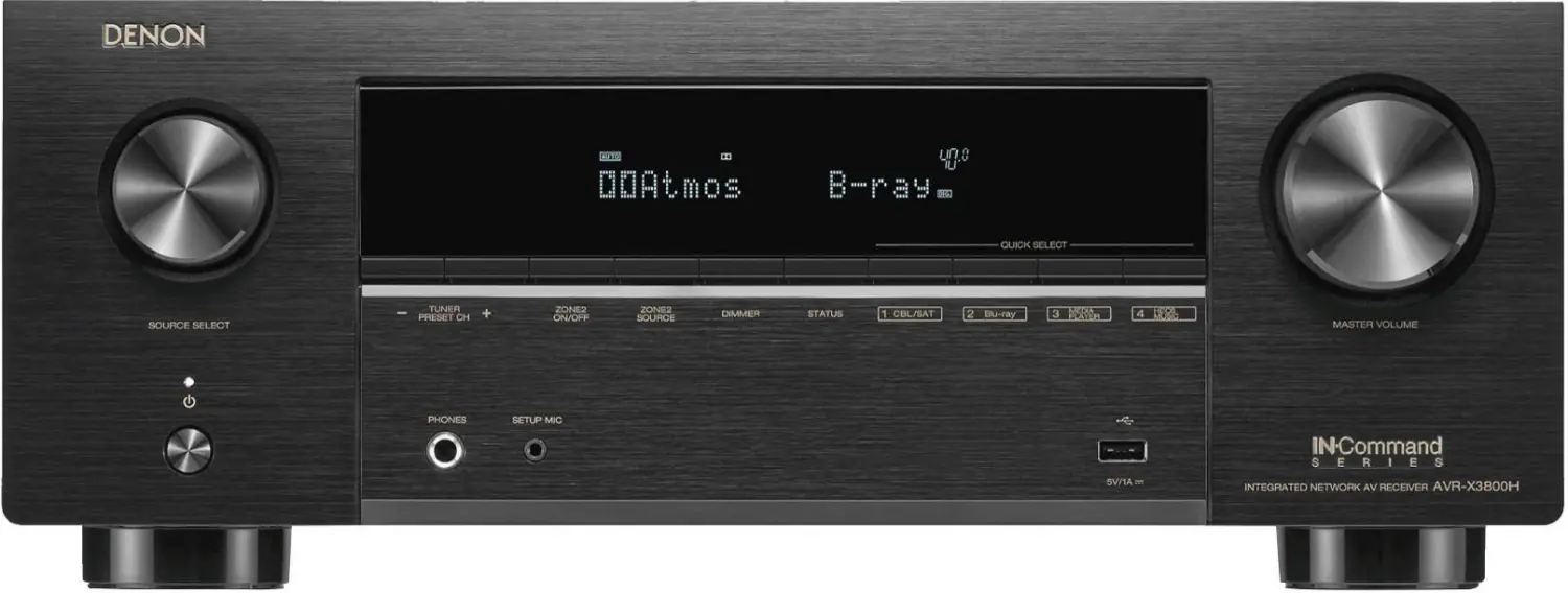

Denon and Marantz products starting from the 3800 and above can all be modified to support Dante. By the way, 99% of modern AVRs can be retrofitted for Dante support, such as the Arcam AVR5.
Regarding your second question (which I might have misunderstood due to translation limitations): The decoder I’m using is the base model with only decoding capabilities and no DSP functionality. The seller has promised that a DSP-equipped version will be released in 3 to 4 months.
Yes, I’ve utilized Denon’s HDMI and Dirac features, but the Dante output on the Denon cannot control the overall volume level.
Volume adjustments must be made through devices connected after the Dante output

To clarify the signal path:
HDMI input → Denon's DSP (for EQ/processing) → Dante interface output → Dante decoder → amplifier → speakers.
Additional notes:
For beginners, this process is challenging as it requires electronics/circuit knowledge.
Costs vary by region and are hard to compare directly. In China, the modifications typically cost around ¥2000 RMB (~$280 USD).
