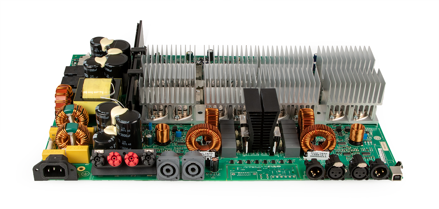

So what amps other than these Crowns use such components/characteristics?
Reactions: pdb
I've never seen TO3 metal case transistors used in a class D amp. This is a new one for me.
These are not class D but standard AB amplifier driven by two rail supply voltages.
