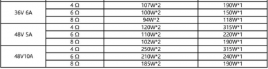

Most of us would like to see measurements with the stock 48/5A psu please ) as discussed below. Aiyima did not specify their test condition so you will help everybody here by doing it. You did it for the Fosi V3 should be fair to do it for the A70 as well ....
See atrached file for what Aiyima claimed
