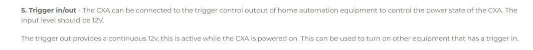

This is a really dumb question but I am considering buying a Cambridge Audio CXA61 and want to know if the trigger from the Ultra would turn the CXA61 on. Anyone have this setup or have any experiences?
It seems the CXA61 has both IN and OUT triggers. So the Ultra should be able to turn it on from standby.
Hi
I have the CXA 81 and recently purchased the ultra, yes the trigger will switch the amp on and off accordingly when using 3.5mm to 3.5mm cable. I have my Ultra connected to the TV which means I now only need the TV remote to activate the TV, Ultra & Amp. Obviously, you need the app or the WiiM remote to access other features but the convenience of being able to use one remote is great.
