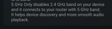

I can't test (I only have 2.4ghz..)
but some have they realize listening in 2.4 and 5ghz?
differences?
I was sitting on the sofa, switching the EQ on and off, while playing a song, no spectral analysis...
Regarding the smoother sound, I think they mean less potential stuttering, caused by possible changes between the two networks, in certain situations, or even by a possible drop in data rate in case of bad reception.
Any audio differences, in condition of good reception, I think just can't exist.
At the beginning of my use of wiim, I moved it to a gray area behind the chassis of the electronics and certainly very rarely there was a hiccup. I don't know if it was a fw problem, now solved but by moving the wiim to a more favorable place for reception, these holes disappeared.
to read you there, we are more in the world of convictions- beliefs than of precise, "searched" personal experience...
"smooth" is a precise term, isn't it?
we are here in the world of people perceiving the differences in quality between 48 96 192 in 24 bits, right? mixed on amazon echo.... or with hard rock etc.. ;-)
so good:
less teasing..
some on delicate music and transparent systems or with good headphones could he dig these two things?
no eq-flat eq? difference in quality?
5g softer than 2.4ghz?

it runs after ultra hd in all circumstances....
but no one to observe if there are differences in listening between 2.4ghz and 5ghz?
or
eq off or flat?
seriously
(the two subjects are not so trivial)
Forgive me if I insist but given the transmission protocol, error correction and asynchronous buffering, without reception problems that can cause interruptions, the data transferred will be the same and therefore the exact same stream will be played, at 2.4 or 5Ghz . To give an example, I don't think a .doc text is more or less poetic depending on the frequency of the WiFi.
On the other hand, it is possible that enabling or disabling the equalizer may involve different phases of software processing, so it is legitimate to question and possibly measure whether there are differences.
