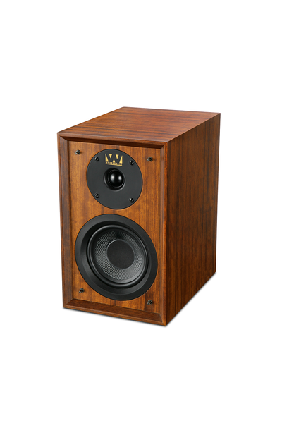

This is a review, detailed measurements and listening tests of Wharfedale Denton 80th Anniversary bookshelf speaker. It is on kind loan from a member and costs $599 a pair.
I don't know if it is visible in the picture but there is a very thick frame with drivers and baffle recessed around half an inch. This makes it a bit odd looking and probably doesn't do much for sonics. The grill nicely counteracts the former, giving a vintage yet elegant look to the speaker:
Wharfedale Denton 80th Anniversary Bookshelf Speaker grill vintage Review.jpg
Back panel causes a bit of culture shock with very modern binding posts:
Wharfedale Denton 80th Anniversary Bookshelf Speaker back panel vintage Review.jpg
Surprised to see two ports instead of a single larger one.
Speaker itself is quite heavy for its size and the walnut veneer gives it a quality feel you don't usually find in this price range.
Note that there is an "85th" anniversary version of the same speaker which uses a different tweeter. Wonder if every 5 years they are going to produce a different version!

Here's it's ancestor from 1969 or so which I have in storage. Two way chipboard box with simple crossover, cast bass-mid chassis, large surround but small magnet, cone-dome purple plastic-diaphragm tweeter tweeter (I kid you not) and a 'nice' if slightly 'foggy' kind of sound which is harmless enough! I sat them on sorbothane 'feet' which helped decouple them from the desk. Back in 1971, a school-pal's Dad had the first proper stereo 'HiFi' system I ever heard. Garrard SP25III/AT66, Metrosound ST20 amp (I have one of these too but it needs attention) and this speaker. many 'prog' albums of the time I first heard through this system and it wasn't bad at all I remember.
Didn’t, you know who, measure this line of Wharfedale and it performed better with the grille (it removes the effect of the baffle Being recessed)?
I don't trust his assessment but yes, I did see that but post measuring this sample.
Never has a speaker company had such a variance of quality between their various models, regardless of price. The Linton and Diamond 12 series are excellent.
A loud pass in my book. When these speakers were current in the 1960’s, most people had experienced only AM radio quality reproduced sound, a 4-inch full band speaker with no bass below 100 Hz and no treble. It must have sound sensational. Having conquered the important lower and higher octaves in the past sixty years from source, electronics and loudspeakers, not to mention SINAD and acoustic power, it is not surprising how disappointing they sound to the discerning ears. Thank you Amir for showing us one of the most luminous advantage of historical progress.
