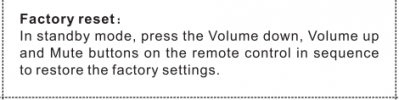

Hello
Can someone confirm that the factory reset sequence works? I just got the DAC and it does absolutely nothing

Hello
You can do a factory reset by following the instructions in the manual. (confirmed on my E30 ll)
