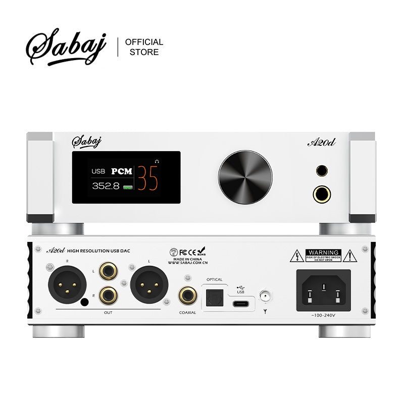

another hpa dac with 9038pro, the battle of cheap HPA DACs is getting richer and richer in contenders
And this one has beefy handles at the front, which will make it sooo much easier to move it around…
