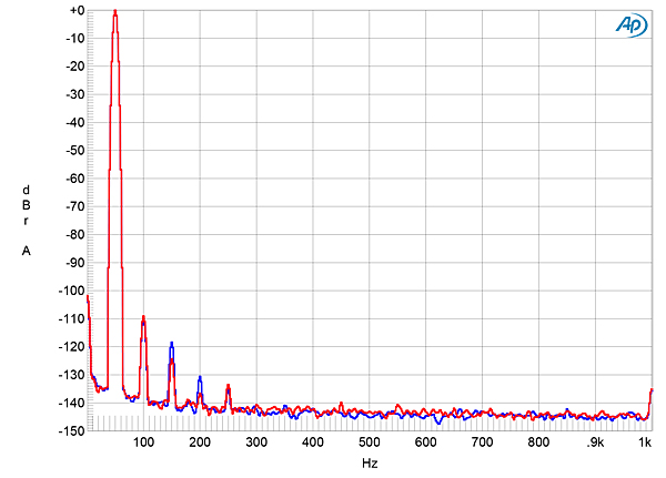

In order to make our tests more comparable to what is published elsewhere, I added a test of 50 Hz tone driving into a very low impedance of 600 ohm as used by Stereophile:
As a way of comparison, here is how the dCS Rossini Apex ($32,800) performed in the same test:
The A20d beats the worst case harmonic of Rossini by 7 dB yet costs nearly 80 times less!

Rossini looks better IMO, the 3rd harmonic is same level or lower and there are no high order harmonics present unlike in the Sabaj. Harmonics decay monotonically.
THat's not the case. The noise floor in my FFT is lower and hence shows the extra harmonics. Stereophile tests simply hide those.
Fair enough, still the Sabaj seem to be more odd and high order harmonics happy than the Rossini, at the microscopic level anyway.
