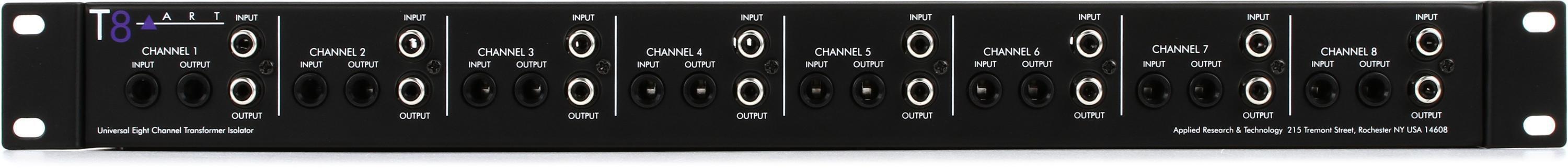

3. Convert RCA to XLR balanced: something like the (to get):
$180 ART T8 8-channel Hum Eliminator / Isolation Rack
$149 Behringer Ultra-DI Pro DI800v2 8-channel Active Instrument Direct Box
Save the money and just use an RCA to XLR cable. That will work just fine and will have less noise and distortion than those cheap boxes.
