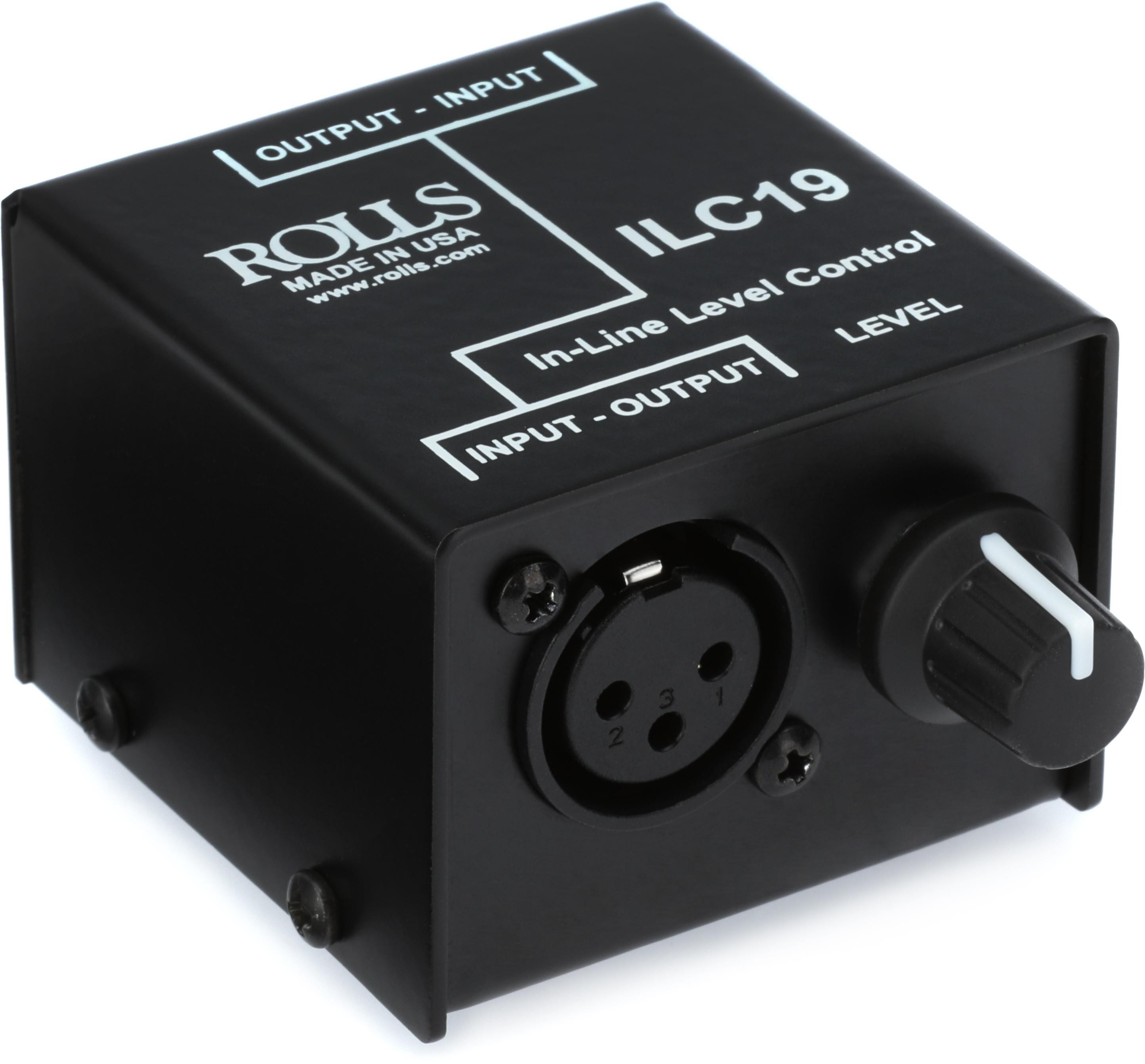

Is there any reason that a passive line level controller such as this is a bad idea for level matching in biamping situations? Will it effect noise and distortion?
As far as I know, should not, only a minor one depending on impedance. Don’t take me serious in my post, I’m quite obsessive in those things, it will work well.
Having the digital volume to low is worse, in general and specially in classical music because of quiet moments, so it is good to add some minimal noise and go far from noise floor in the DAC.
I might add that this will be used on the low pass section with a 25’ run before and 3’ run after.
25’ is getting long.
At least the price it right if it does not work well.
(Hence - I would start with 1.)

A passive volume control is a potentiometer. This has to be a reasonably high resistance, otherwise it presents too high a load to the source.
But this necessarily means it's output impedance is high. So if you use a 5K pot as in the device linked (already low compared to typical RCA input impedance), then it also has at a 1.25k output impedance (when at -6dB) - this is around 10x bigger than the typical output impedance of an active device.
So the following cable capacitance will have 10x the effect on frequency response as it would on a typical active output. This can then become audible if the cable length from the pot to the destination device has enough capacitance.
