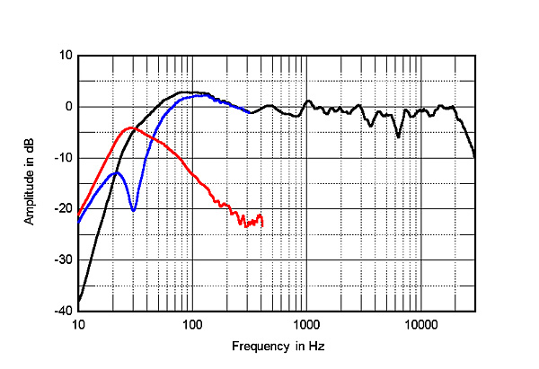

Measurements are a bit meh. I wish Amir or Erin take this and measure it.

The directivity is wonky as expected. If you have a 8" woofer crossed over to a ~1" tweeter you need a lower crossover freq and a proper waveguide. The Grimm LS1(Be) is a good example with the Seas DXT tweeter.

Also the horizontal directivity till 10 kHz looks better than I would have expected for such a 8"/1" without waveguide
since the the 6 kHz peak off axis is rather an artefact of the on-axis dip on that frequency
as JA unfortunately has chosen to plot them normalised.
(Source of above measurements: https://www.stereophile.com/content/mission-770-loudspeaker-measurements)
Would love to listen to them but 5 grand pair price is also quite a substantial price for such a passive 2-way, even more considering that the 3-way Linton also designed by him can be bought here in Europe for less than one fifth of that price.
My guess is that 3rd order acoustic slopes he chose in the crossover compensate frequency off axis. Reversed phase on axis probably doesn't result in a deep null in frequency response.
